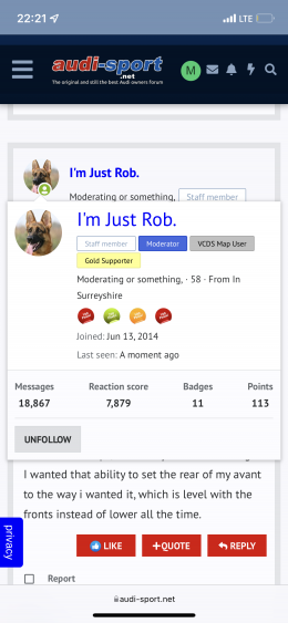

Very easy.
Click the icon of the member you wish to message, you will see a tab on the bottom that says " start conversation" just click it and away you go, simple as that :yes:
I dont have a start conversation button
