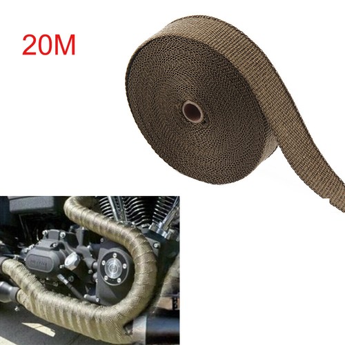

Looks like the DP turned out very well! You weren’t far off where you thought the wastegate pipe would end up what do you plan on wrapping the DP up with? Always curious on what peoples thoughts are of the wrap you can get, I assume there are better ones than ones that generally fall off after a few heat cycles.
I only ask because I’ll be wrapping my DP, well some of it that is….. 3.5” doesn’t leave you any room for any form of wrapping
I just use relatively cheap titanium stuff... this is what I bought this time around...
I used this on my mani and DP for the 20v... lasted decently enough although arguably due for a re-wrap before the rod went... I have found they are all much of a muchness tbh... the really cheap white stuff seems to fall apart in weeks but not had any real issues with the titanium stuff

Cheers mate, I’ll put that in the basket for the moment. I’ll be doing my wastegate pipe and the top half of my DP in wrap I think. Areas which are “easiest” to replace when I need to.
