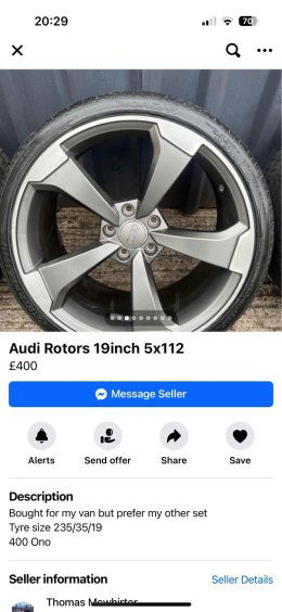

I really like these but they are 255/35 19 with an et35

I went to look at these last night and even while my car was on the jack, they still rubbed on suspension

look at them in the flesh before you part with the cash, rotors are nice rims but aftermarket ones suffer from cracks/weld etc, and OEM ones can be expensive and also suffer from damage.
If in doubt take a jack and test fit one, most genuine sellers will let a buyer test fit one.
Personally tyres are too wide but maybe just test fit one, it will be tight and also its not just the rears wheel arch, the front upright steering knuckle , too wide with the wrong offset and it will rub on the strut.
They wont fit due to the offset used on the TT , that said guys do fit them but with a lot of messing around.

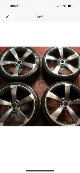

The rota ones are on eBay and are in Belfast so can’t test them and don’t want to end up being stuck with them.
The ones are the Facebook link touched the suspension, but maybe would be ok with spacers?
Thats the thing, as soon as you add spacers it can go the otherway so you need to be so careful.
B7 doesn't have a lot of room to manover with wheel upgrades due to front upright being so close to the tyre sidewall and rears rubbing on the wheel arch, it becomes a balancing act to get things just right.

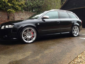

last year i had a set of 19"Oz alloys fitted 8.5j et38 i think with 235/35 19" they were spot on and even cleared my 18z's , but it's not often things go that easy.
But then i have had soo many different sets of alloys on my B7 that I've lost count now..lol
