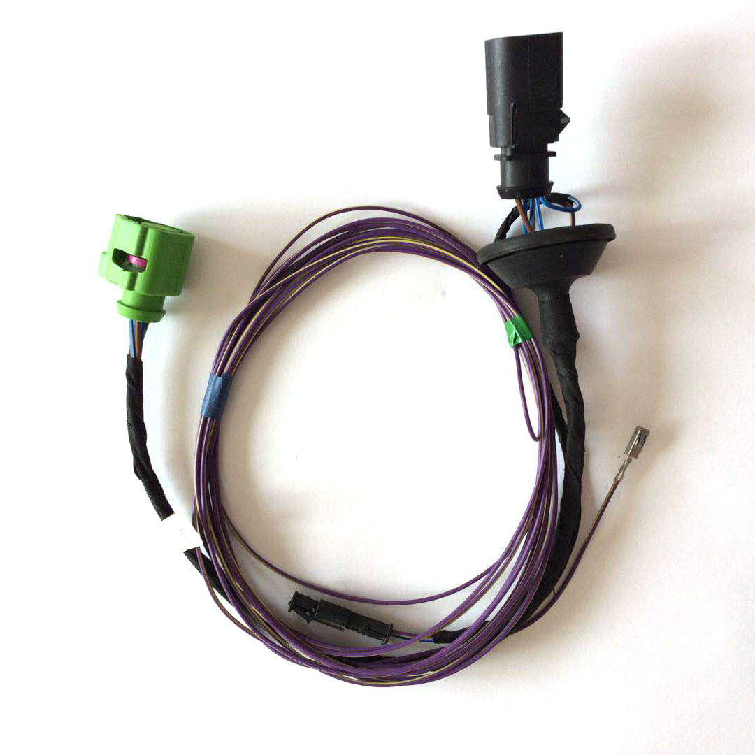

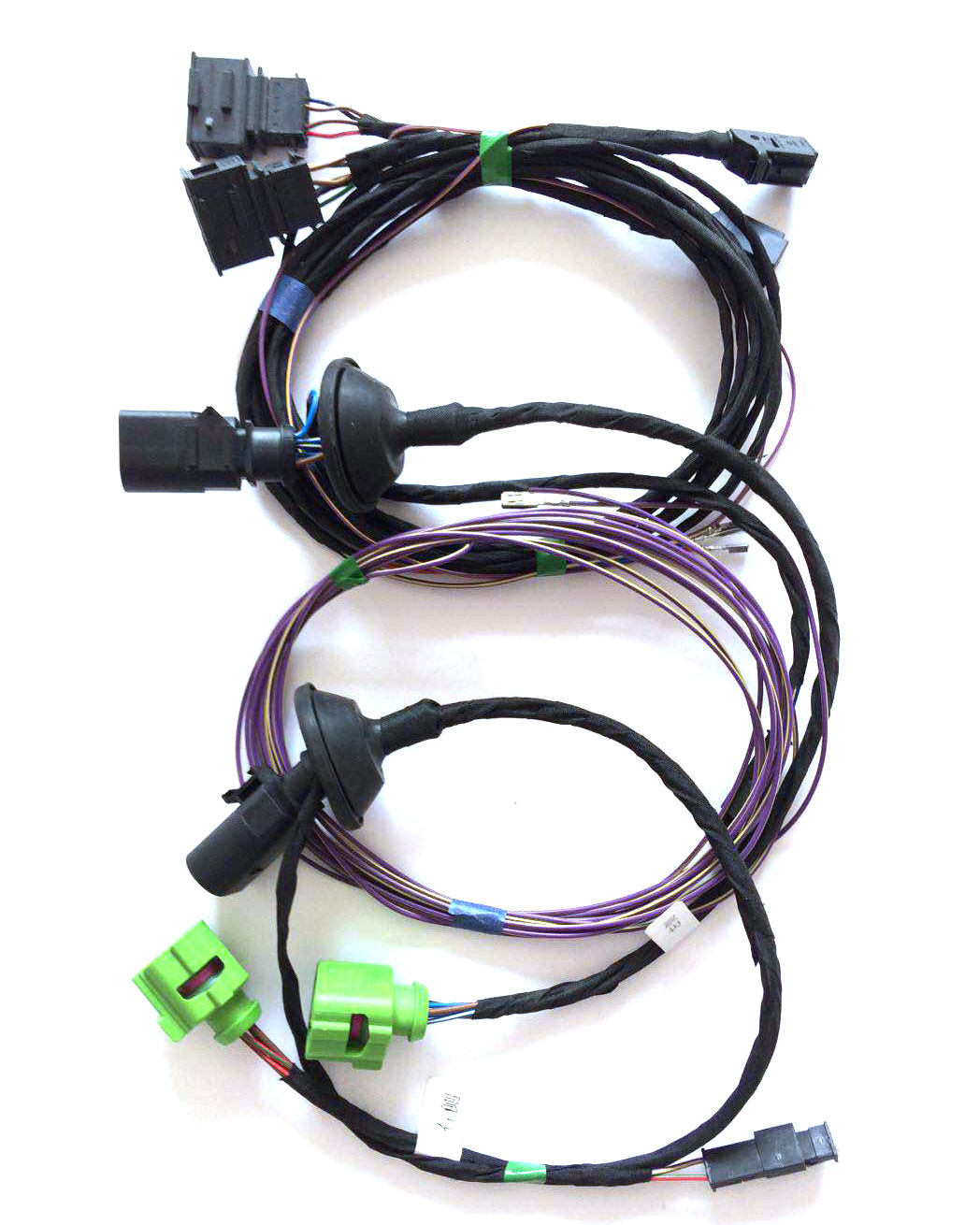

1 Cable goes to fusebox 12v always on.
That cable is rooted to all taillights. (if you have towbar or the towbar cable preparation behind the left storage area you can use these cables, make sure its properly fused.)
The middle turn signal wires coming from car are not used. There is a wire from the side cluster turn signal rooted to the middle. (the prefacelift have 4 wires coming from bcm to each turnsignal lamp. Facelift only uses 2. cousing lamp out error.)
There are a couple adaptations to be made but you have to ask Djalix for them.
https://nl.aliexpress.com/item/33003769468.html?spm=a2g0s.9042311.0.0.47954c4dhXgU97
These you will need.
Thank for fast respond. Only these 35 dollar and that's it ? So how come BKS 470 dollar? Or they added some empty box to it too look expensive?
And you need Djalix to do the coding....
No need for expencive box...
12v you need to get dynamic part working.
Djalix you need because without proper coding the Dynamic taillights wil run out off sync with engine running.

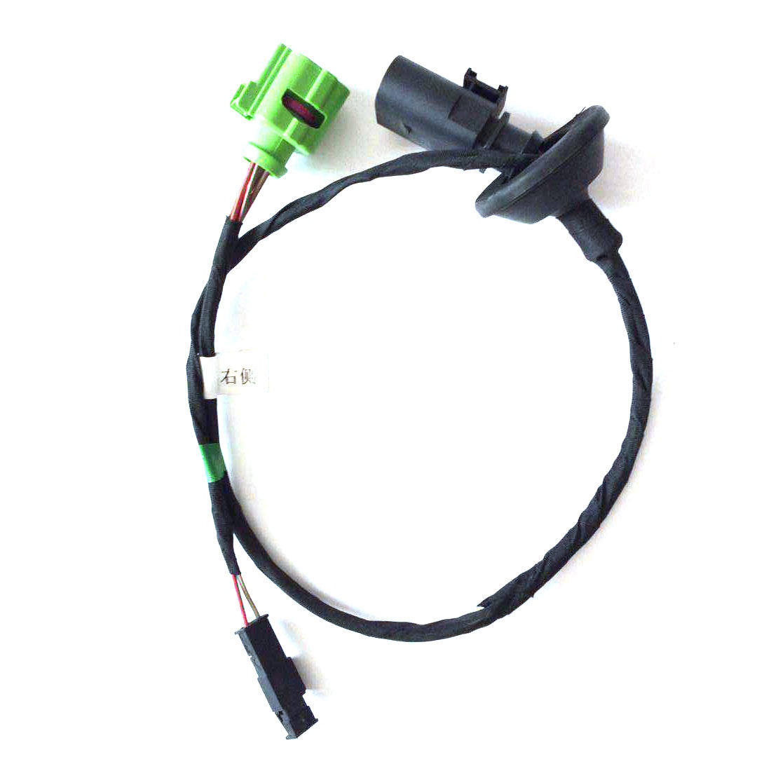

Right side:
Green goes to facelift outside taillights, black to origional harnas.
Small black goes to inner lights.
Left side
The purple wire is the 12v always on to fusebox.
The wires inside the hatch(the taped black): plug n play. (inside turnsignal wire seems incorrect if you compare car harnass to connector, but it gets signal from outside turnsignals, So dont change this!)
Just buy the led connectors and tweak with vcds.
Repin the connector (pinout on page1)
For vcds: print your admap and get one from 13-16.
Should be easy..
