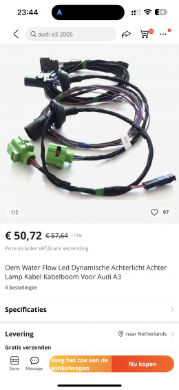

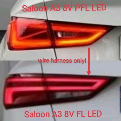

Anyone doing A3 8V Taillight conversion can send me PM if needing any info/help or harness/coding
There are multiple variations between 3 door 5 door and saloon/cabriolet, between PreFaceLift and Facelift, both Halogen and LED, connectors are different, and coding is different.

Hi i’m new here and would like to retrofit the fl rear lights in my pfl A3 Sedan. I’m having OEM led right now and bought 4 new fl units. Now looking for the wiring loom but is the one from Aliexpres the right one? Like the one i attached?
hope that someone can help me
kind Regards!

Hi
you have PreFaceLift Saloon with LED tail lights and you are changing to Facelift LED tail lights?
AliExpress harness will do the job. It connects inner and outer lights, each side and it will have two long wire lengths, one each side. Those wires need connecting into 12V supply for sweeping indicator to work.
If you use cig.socket/powersocket to supply those wires, then with default fuse position You will have sweeping indicator Only during ignition On. If you supply direct from battery, you need to consider routing harness to the front but then sweeping indicator always.
Another issue, inner and outer sweeping indicator will go out of sync at times with battery voltage fluctuations. Check issue reported by other users on threads about That can only be resolved with coding using VCDS or OBD11Pro.
A different harness design below in link. All connections between original wires and new lights, linking harness between inner and outer lights each side. And rest coding to match factory fit parameters and you will have no out of sync indicator, no extra wires to tap and will have sweeping indicator functioning like factory fit.
Kufatec also do a simpler design harness that comes with single use coding dongle but cost is high
From pfl led to fl led Ypu can buy plug and play zero coding adapters but their cost is extremely high.
