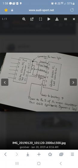

Hi all, I've wired up as per the attached diagram but my inner brake lights aren't working, all other lights in and outer are working as expected with no coding, going from pfl led to fl led. Can anyone shed some light on what may be wrong.
Brake is straight connection. Should work without coding unless you have turned it off with coding.
So you either dont have wires connected correct.
Or messed up on coding
Or faulty light.
This doesn't list a brake wire only a tail lamp wire which I'm assuming is the normal lights not the brake light? I've done no coding as of yet
This wire diagram is correct so irrespective of what is going on with inner light Your brake light should work.
Old outer connect pin 3 to new outer connector pin 3 for Brake is correct

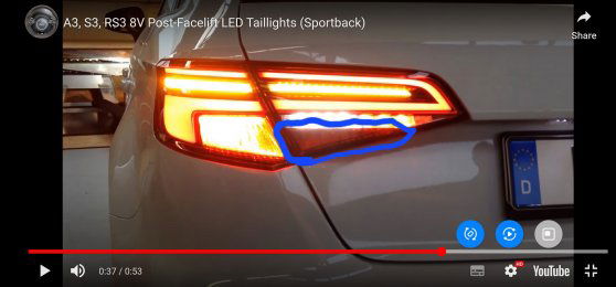

Looking at this it looks like the inners don't have brake lights? Is this piece just a reflector?
Brake outside only
Not sure, dont think this part is even a reflector. Need to test it but definitely not light

Brake outside only
Looks like everything is working as it around then, thanks for the help

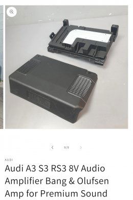

Now I have a clicking sound coming from the box under the passenger seat when putting my foot on the brake and my left brake light is out... any ideas?
Interestingly enough it's a clicking sound coming from the B and O amp under the passenger seat so it may be completely unrelated to the brake light outage, just odd it clicks when I push the brake pedal, only happens when the car is running too...
Sorry cant say why light has gone out
As for the noise, i would say that has got nothing to do with Brake function or the lights at the back.
All sorted had a wire shorted to ground, vcds to the rescue with fault codes...
