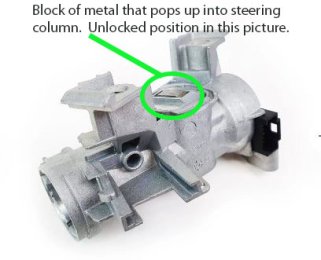

Okay, thanks for the clarification of the part numbers and your other advice. I attached some pictures.
The first of the Transponder 107905855CF.
The second picture of the ignition barrel, 1K0905841 (screen shot from your link, I think) where I've circled the "block of metal" that goes into the steering lock, just to confirm we're talking about the same part really. In the picture "block of metal" is in the unlocked position.
The third picture, I found off Google showing the back side of a barrel.
drill through the black circle plate to break / remove the springs and release the steering lock
I was wondering if you're talking about black circle I've circled?
Also, I take it that the current barrel in my car 1K0905841 can be damaged, drilled on removal if I'm replacing it with another barrel. As long as the Transponder, 107905855CF doesn't get damaged, as I would need to put the transponder onto the new barrel, to be able to use the same keys.

The black circle I'm talking about is on the front-facing side of the ignition barrel. The bit you've circled is the key position sensor (tells the ECU if key is in the off, on, ignition position).
Correct

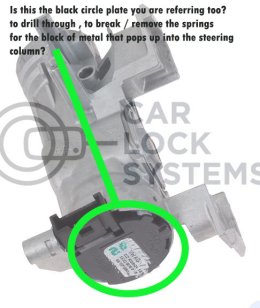

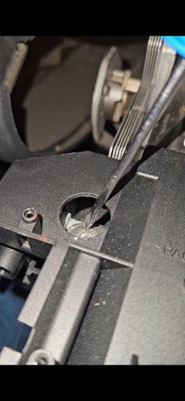

While I'm fresh off the call. I called a different Audi, said I was having an issue with my key not turning and the steering wheel not turning. They advised the same part as the other person after putting my reg in "lock cylinder for ignition starter switch" for £259.08. I said "I wanted to get the barrel, the lock goes into", after a bit of back and forth, as he was saying I need the "lock cylinder for ignition starter switch" if I'm having problems with turning the key. I gave him the part number "1K0905841", that I said I believe is the barrel. He said "no sir, that's the steering lock" I asked how much is that part, he said £163.73. 2 days to order the steering lock, about 2 weeks to order the "lock cylinder for ignition starter switch" from Germany and have coded to chassis. As far as I've picked up is as long as the 107905855CF is not damaged I can fit onto new barrel.
Do they refer to barrel part as steering lock? I would call the image attached to this post the "barrel part", but it seems he was saying that it was the steering lock, after he entered the part number 1K0905841, I gave to him.
At the 2.04 mark is that the "black circle" you were talking about? I've also attached a picture below and circled the bit in blue.
I've got no idea what he means. There is no separate steering lock part. Maybe getting confused with the transponder again, which would require coding if you brought it new.
View: https://www.youtube.com/watch?v=adytI-G2dAQ
That's exactly it

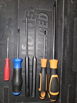

I've dug out some of my tools. I have an older Halfolds Advanced Toolkit, so I have most of the Torx screw fitting that were mentioned. I don't have the Torx 8, so either need to find a tiny flat head screw driver that could fit or buy one.

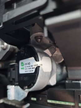

Thanks again! I'm sure I probably have a precision set somewhere at home, that I will find one day when I don't need it lol. I got to the part where I needed the T8, so had to stop there. I see a sticker on the "key position sensor" aka "the black circle" on the left hand side, whilst the barrel and the unit underneath is still attached. The "key position sensor" aka "the black circle" had a sticker on it with
VW AG
CZ K03 04 1535 00
1KO 905 865
08/07/20/R.

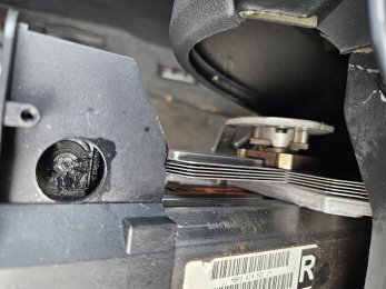

I'll upload a picture from my phone in the next post. I think this is probably for the "key position sensor" aka "the black circle".

Good job. That part number is for the key position sensor or "ignition starter switch" as it's called here: https://justgermanparts.co.uk/produ...starter-switch-vw-audi-seat-skoda-1k0905849b/
If you order the ignition barrel from the link I sent previously, it comes with a new one of them pre-installed.
And just to be double clear, you shouldn't drill through that! The "black circle" you can drill through is small and made of metal, as you identified in one of your previous posts.

After dismantling it was indeed, the part number you linked to first of all. 1K0905851. Ordered yesterday, and it's due to arrive this afternoon. Torque wrench should also be delivered to a nearby collect point.

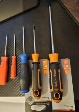

I'm having difficulty removing the left side shear bolt, I've got the right side one loose but can't get a good angle on the left side shear bolt. I have a chisel but, it's way too big, practically the size of the hole where you go through to the shear bolt. To do the right side shear bolt, I went through the front with a small screw driver, that was able to grip it.
Is it just a case of getting a smaller chisel? and do you do it from the top for the left side? I have a small screwdriver that can go in the front slot but the "stick" is not long enough as the handle hits the front casing, where the indicator used to be.
Great news, well done mate. For both of them I just used a long flathead screwdriver, an old B&Q one like this https://www.diy.com/departments/mag...iver-sl-5-5mm-x-150mm/1782622_BQ.prd?alt=true
Can't remember which angle I came at it from, but any angle where you can get some purchase on the head of the bolt should work out, eventually..
Reactions: dk1234
Cheers, I tried for over an hour but no joy lol. I went to an B&Q and grabbed that screw driver along with a smaller one, as the big ones I had didn't work. The little red screw driver managed to get the right side turning, but that one has better access through the front. I'll post a couple of pictures. I used the red pick on the end to try and groove a slot into the bolt. I guess the angle is not quite there to push the bolt.

Hey, I warned you it's a fiddly job! Just be glad it's you doing it and not a mobile mechanic charging £100 per hour!
It will eventually go, it just takes a lot of perseverance.
That groove you've got will really help, though I'd try and make another one 90 degrees to the right, so that your screwdriver is facing straight from the driver's seat. This should let you get a lot more force behind the hammer without the dash / windscreen getting in the way.
Once your screwdriver is nicely seated, give it a ****** good smack. Then seat it in the groove again, and another big smack. Lots of little taps won't be effective.
Also if you can pick up some penetrating fluid that could help!

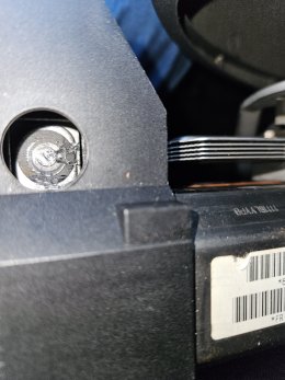

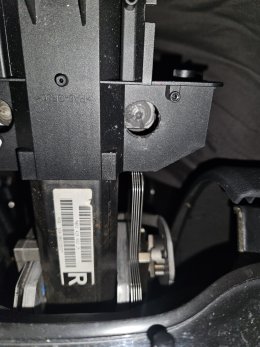

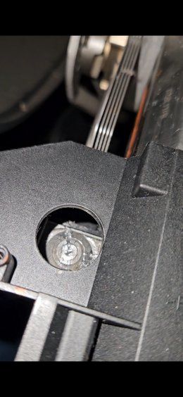

Definitely a fiddly job! Once I get the left bolt off, I'll be half way there. The left bolt is proving a pain, I've just spent an hour and a half trying to get it off today. I think I better order some penetrating fluid. Bought some pin punch pieces, the smaller one in the pack couldn't quite grip the small groove I made on the right of the bolt.
My drill is bigger than the screwdriver you mentioned so I can't use that because of the speedo bubble / dash.
Is there any dremel bits that could be used to get down there? I have a wired one with basic accessories but I can borrow a powerbank to use it, but not too sure which sort of piece I would need. I guess I could cut a "flathead" into it if I can find a piece that could fir in the hole.
I've attached a picture of the bolts current state
You must be almost there now..
I didn't try it myself, but if you have some mole grips you could try turning it on the underside via the bolt itself? The plastic bit might get in the way through
You may be able to get a deeper groove with a dremel, but the trouble is going to be getting a bit long enough to reach without hitting the plastic bit.
Keep on it!

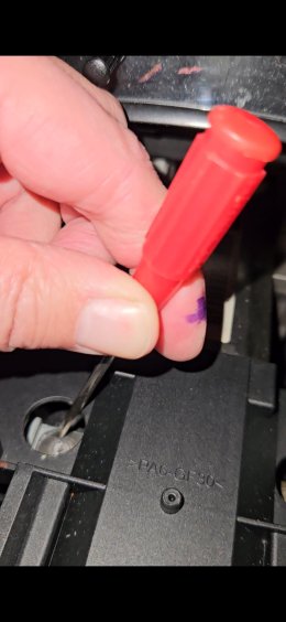

Yeah, I hope I'm nearly there lol. I might see if I can get a small chisel. I might aswell pretend I'm in Prison Break, trying to cut through the wall with a toothbrush lol.
Penetrating fluid, would normal WD-40 do? As I have some at home, but if there's something better I don't mind grabbing that.
I just watched a video where the guy files the holes abit bigger with files. That might be an option. I tried to upload 2 pictures of the bolts but only 1 loaded. Uploaded a picture of the punches I tried to use through the front, as they were too big to use from the top.
Normal WD-40 might help but I'd get some actual penetrating fluid - WD-40 do make some and it's pretty good. Check Screwfix.
Give it a go... if you're really stuck it might be a case of dremelling off the plastic thing to get at the bolts, though I don't think they're a readily available part..

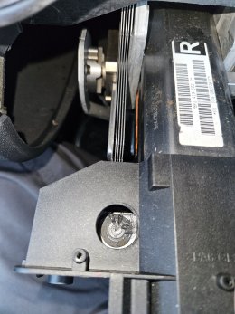

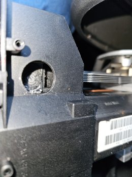

Tried some penetrating fluid this morning, left it to sit for 5 minutes before trying that dreaded left bolt again. Tried for about an hour, still no luck . I've sprayed the nut again and will leave it for abit.

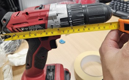

Somebody has a drill that might be able to fit in the space, as it's smaller than mine. I might be able to borrow it for lunch time. I grabbed a set of these extractors from Screwfix, these one's here. https://www.screwfix.com/p/screw-bolt-extractor-set-2-pieces/2951v. I haven't used this before, but I read you use a small drill bit, smaller than the extractors and than bang it in about 5 mm to 10mm deep.
I've attached pictures of the bolt in its current state.

The drill I borrowed was too big, with shaft being 21-22cm long. Couldn't get under the bubble without a drill bit inserted. There was a small Dewalt impact driver I could borrow but it takes sockets, so I couldn't fit drill bits into it. I'm thinking of buying a right angle drill, with chuck, hopefully I would be able to use extraction tool with it, not sure if the depth would be an issue.
On a right mission!

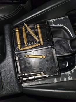

Quick question. What is the security bolt made of material wise? My drill bits for metal, are taking ages to make a hole. Spent about 4 hours to get around 3mm to 4mm max hole. Is there any sort of drill bit that's recommended for tackling the bolts?
Had a 1 and 1.5 drill bit snap, but pushing them down at a slight angle. Tried some scew removal bolts I borrowed but I think I didn't drill deep enough, tried the ones I bought aswell but, had the same issue. The drilling end of the ones i borrowed barley dug deeper than what ever hole I made with the drill pieces.
Carbide drills should do the trick
Cheers, I grabbed a couple of drill bits from the local hardware store in the morning, after much more drilling I was able to get the nut out with screw extractors. It was a mission. Now, I've got the ignition barrel out.

Here's a look at the pesky bolt!
