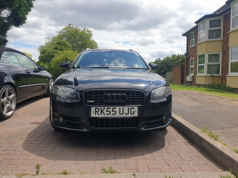

2 days ago I had enough of the clear headlights with the butt ugly chrome and orange indicators, so they got the Joey-mod treatment and now the front looks all business. I do however need to get some new silver bulbs as the chromatic ones i have right now somehow still show the orange ever so slightly at certain angles. Will order those today. I'm not done with the headlights by the way they still need to get projectors and drls, I couldn't find the lot so once i've located them that means me taking them off and apart again.
And yesterday I finally aligned the frontbumper and bonnet properly.
it went from this:
to this:
If you ask me way better than before
Reactions: Gmac and Charlie Farley
De-tangoing the headlamps makes such a difference, just makes the car look a bit more up-to-date. :thumbs up:
Reactions: northpole
I actually de-chromed them too which makes the biggest difference. Now I didn't touch the reflectors at all as they are the halogen headlights and need the bowls to reflect the lights onto the front. So instead of just going satin black, I used a really high gloss clear coat and gave it 3 layers so the light output is the exact same. It reflects just as much as the chrome part did( basically a black mirror) so I put safety first.
It looks like they came out of the factory like that and that was my main goal keep it oem looking but fresher than it did before. And if you look at the before and after picture you'll notice the foglights have the same black internals as the now joey modded headlights. In other words: they should've done it at the start.
Now I did remove the orange lenses and I might just tint them and put them in as that'll make it look different completely. But not sure yet... I'll decide on that when I add the other stuff.
I went for Philips chrome indicator bulbs and they work a treat and no orange. Front looks loads better, nice one!
