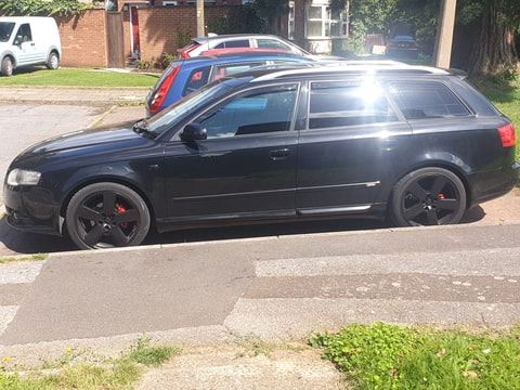

and for everyone's viewing pleasure... here are some pics of the car
