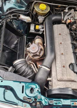

found a very small coolant leak at the back of the engine. It was also clear the rocker cover gasket was starting to go as it there was a fair amount of oil at the back of the engine.
Before I tackled the above jobs I got on with the aircon system as I got some parts to get the system working again. So fitted a replacement compressor with replacement lower pipes that were free from holes.
1651954116085
So with that done I went off to get the system gassed. Which did not go well. First there was some confusion about how the system was filled as the low pressure side port is a screw thread rather than the push fit on the R134 systems. So went with just testing the system using the high pressure port. That found another sizable hole behind the protective on the pipe in the image below as you can see some of the green oil that was spat out.
1651954124434
So at this point I got a little fed up with the car so purchased a new toy to fix that sort of BS.
1651954134637
After a long talk with the guy's at r-tech I went with the digital version, as it does appear to be easier to setup.
1651954166558
So on with fixing the pipe. The hole first hole was easy enough to repair. Once done I noticed the nut at the end would turn but not move down so after a bit of a smack it moved and it presented me with this.
1651954225258

Had a couple of error codes on the car.
First one is this
00561 - Mixture Adaptation
13-00 - Adaptation Limit (Mul) Not Reached
Second code is
00544 - Maximum Boost Pressure Exceeded.
This happened a few weeks back when I was on my way back from meeting a friend over in wales. I was doing an over take and very soon afterwards it started to cut the boost no matter what gear I was in! I pulled in a little further down restarted the car and it was back to normal power. I've tried to replicate this again but with no luck. I wonder if I got a little to close to the red line.
I've cleared the codes and only the 00561 came back. After talking with a few people about the fault they all said the same issue which was a boost leak.
So I've started to make my own boost pressure kit. Got one of these for £9. It's a cheap 79mm hole saw.
1663359541958
It was chopped down and welded all the holes up except the centre hole, as it was a perfect fit for a tyre valve.
1663359554662
It still needs a coat of paint but it should do the job.
To plug the boost pressure control valve, I've cut off the top of one of the old S2 front shock absorbers. It's was a perfect fit.
1663359581070
Was also told to check the crank ventilation system. I'm glad I did as it was in a bit of a state.
Valve was caked with thick oily crud inside.
1663359717522
Then I found this.
1663359731924
Which I found it inside this pipe
1663359762781
I cleaned it up and it now looks like this.
1663359786742
VW/Audi call it a "Flame Deflector Plate" and has part number 035103477A They are obsolete but can be purchased from VW Classic and Tradition. Will just be cleaning my one up and putting it back in.
It should look like this. I flatted my plate out and gave it another clean so it does look at little better (Not that you will ever see it).
1663359905246
Got new valves sorted.
1663360118868
Also cleaned up more metal pipe work in the engine bay.
1663360172085
Quick blast and it's come up Ok. Then spray coated in epoxy.
1663360188653
1663360193526
Once the breather system was refitted. I started the pressure test. I used a Makita 18v tyre inflator to pressurise the system, as I could not be bothered to get the compressor running and get all the hoses out.
1663360257776
Started with a low pressure of 8 PSI which instantly got results. was getting a bubbles from the idling speed control valve.
1663360277216
I also had a very loud hissing coming from around the turbo. I ended up removing the bumper which did not make much difference to be able examine the hoses while fitted to the car. However it allowed me to remove the lower hose and test it off the car using some more modified hole saws. Tested all the pipes individually going to the turbo but found no leaks.
I'm guessing the lower hose attached to the turbo was not secure enough or it was not on correctly. Either way after putting the hoses back on and making sure they were all secure, the hissing noise went away. So I can only think that was the source of all my problems. It's nice and dry at the moment so will take the car out for a spin and see if the fault codes return.
I also don't believe any of valves that I have replaced were the cause of the fault code. However I think changing them was the right thing to do. They have seen 110K miles and are 27 years old, they were also cheap enough and not too much damage to the wallet was done by changing them. It was also good to find and clean the flame deflector plate as that must have been creating a blockage in the system.
Took the car out for a nice long run and it's now pulling very well all the way to 7K RPM. and I no longer have any fault codes.
