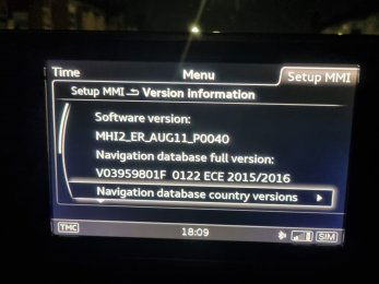

Hello, new here and just after some help.
how do i know which firmware to update to?
I have a bose sound system (black edition A7 C7 Facelift)
I am based in UK/Europe.
I currently have Software Version: MHI2_ER_AUG11_P0040.
My current Maps Version is: V0395801F 0122 ECE 2015/2016.
I found this site: https://mibsolution.one/#/1
but too many downloads and not sure which one to do.
Link in post #64, three before yours. It's the AIO, all in one update. See readme regarding Bose, iirc you don't ugrade Bose module. Watch Mr fix tutorial in #63. Link for 2022 maps in the notes there, once you've done the AIO. Use 32GB sd cards, fast ones, or MSD with SD adapters. Some old SD cards won't read fast enough and will exit the update. Good luck.
