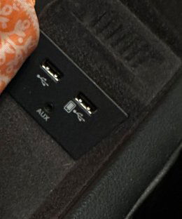

I am using a USB plugged in the arm rest as I did before the update. Before the update it was fine, continued where the last song ended. After update, each time car is restarted, the music will go back to folder 1, track 1. This is with phone unplugged too. So literally can manually play any song, turn off the car, go have a cup of tea and back to the car where its back to first track.

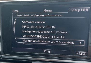

good morning everyone, can anyone help me?
I recently bought a 4th generation Audi A6 C7. I have the software version MHI2_ER_AUG11_... I would like to update the version to be able to use Apple Car Play. Can you tell me where I can download it and if it is compatible with my car. It is an A6 registered in 2014

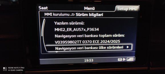

Hello Friends from Turkey,
I have MIB2 system in my Audi A6 sedan vehicle, current version information is MHI2_ER_AU57x_P3634. Androidauto / Carplay is currently active in my vehicle. However, I have problems from time to time, when I connect my phone to the vehicle via USB, sometimes Androidauto / Carplay does not work, only the phone charges. Sometimes when I connect my phone to the vehicle via USB, it does not even charge.
I want to upgrade my MIB2 version to MHI2_ER_AU57x_K3663_1_MU1425_AIO. Thus, I believe that these connection problems I experience from time to time regarding Androidauto / Carplay will be solved with the version update.
I need support on the following issues before updating.
1- According to what I have read on this form site and other form sites, the K3663_1_MU1425_AIO version is a newer/up-to-date version than the P3634 version currently installed in my vehicle. Is this information correct?
2 - Is there Turkish language support in the MHI2_ER_AU57x_K3663_1_MU1425_AIO version? (There is a Turkish language option in the current version.)
3- There is currently a navigation version 2024 - 2025 map, I do not want my navigation map to change in the version update I will make. Is this possible?
Thank you in advance for your support...
Adnan :)
