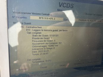

centralina di assistenza al parcheggio: 8P0 919 475 J
Errore effettivo: 01316
Ho scattato foto ma non riesco a ridimensionarle, allego qui quella dell’errore che leggo

Qualcuno che sappia dirmi con certezza se per il Park Assist è necessaria la scatola sterzo GEN3? Nella mia auto ho una GEN2.
I’m sorry. I wrote in english, but automatic translator modified in italian. I'm not able to modify previous posts, so post again now:
my park assist doesn't work. With VCDS I write:
Error 01316 - ABS - 013 please read foults memory
I checked all the connections, all 8 sensors, the two buzzers and the 2 buttons. Everything is connected correctly.
The problem lies in the lack of communication with the ABS control unit. The ECU code is 1K0907379AD.
I have a GEN2 power steering ECU and not a GEN3, I hope this is also not a problem for the park assist.
Someone who has done the retrofit on the A3 with these units and/or who knows how to help me?

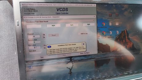

On steering assist - adaptation - installation park steer assist - 0 - everything good

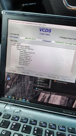

And it throws a error code only on the pla module
"1 Fault Found:
01316-ABS Control Module
013 Check DTC Memory"

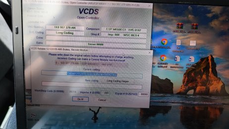

The abs module is 1K0 907 379 AN
ESP MK60EC1 H45 0107
WSC 06314
And the coding for abs is 1142401209240000881302EC901D00423800
No errors on the abs, on steering assist, on navigation, on gateway, on instruments... only on the pla module.

The last bit is i think bit 17 and it's only tmps and another thing.. don't remember right now how it's called..but if i enable it...it throws the code " coding rejected out of range"...
I hope that is something else to do in coding the abs and it's not needed changing the abs module
