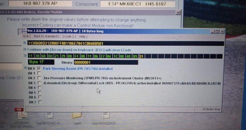

The coding for the MK60CE1 contains the last 6 or 7 digits of the chassis. Some very clever people have worked out what digit translates to what. I’ve got the info saved so if people need it I can post it anytime if needed. It’s also got the coding changes needed for park assist but I think thats in the golf guide too.

thankyou, am I wrong in thinking the mk60ce1 will come from factory with mine? It’s a 2011 S3 3dr
It should I think they changed it around 2009 ish but if I’m doubt you could always call Audi or tps and get the part number.

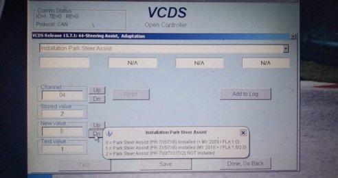

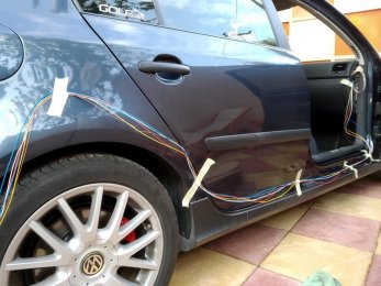

hello everyone!
New here and forgive me, not an Audi owner, but a VW Golf! But bear with me!
First of all a big THANKS to all posters in this thread, especially to @George Kost, for his help (we talked in Messenger as well!).
Well... this thread was the inspiration for my retrofit!

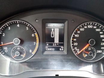

My car is a late-2008 Golf Mk5 TSI (140HP, DSG6) model, but with some very good factory installations. For excample, the ABS unit is a MK60EC1 (AP with long coding!). Also the Can Gateway was a Q, later exchanged for an AA unit.
I was researching the PLA retrofit for maybe three years now.
I finally did it and IT WORKS!
What did I do?

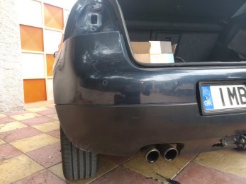

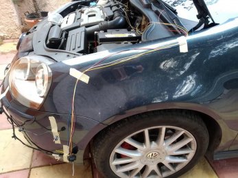

I started looking at ebay used parts and also got a few new ones.

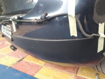

Used and new parts: rear bumper harness, complete with 4 sensors!

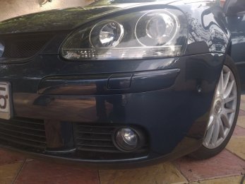

4 used (FIAT, no less!) sensors for the front bumper. (They are Valeo, exact same Valeo part number. Still working!)
Used front bumper harness
Used PLA 1.5 module (1T0 919 475P)

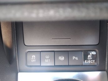

Two buttons for the ashtray
two new PLA sensors for front bumper
various brackets, connectors and holders were bought new from local VW/Audi dealers
After consulting with George, I bought a lot of cables from conrad.de so I built my own harnesses:
One from the front bumper to the PLA unit.
One from the rear bumper to the PLA.
One from the PLA to the Can gateway and the fusebox.
All the time I was messing with this, I was coming back to this thread to get ideas!
It took me the best part of four months to complete!
Here is my detailed story:
I know it's in Greek, my native language, but you can right-click and "translate" to your own language. I think it will make some sense!
Also... a video:
A couple of months later, I upgraded my instrument cluster with a white one from an EOS, and it shows in there also, of course!
Once again, thanks everyone in this thread for their specific and interesting comments!

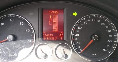

Well... my car is a "previous" generation (2004-2008). It would not accept the PLA 2.0 as it is. I would have to change the ABS module and pump with a B-model, which is something I sould not do! I am a bit afraid to mess with that! however, my AP ABS accepts the PLA 1.0 or 1.5, so I went with 1.5!

I’m still trying to get pla 2.0 to display properly, I’ve a mk6 golf dash to play with and a couple 8V ones. My plan is to either custom firmware it or make some sort of hybrid spawn of a dash lol
I would go for pla 2.0 if the dash would display properly! So keep as informed if you sort this out!

On the A3 though as Troubs said, the gen 2.0 does not display correctly when changing from parallel to bay parking.

Hey! First of all, thanks again for the inspiration, pics, words, everything! We will stray away from the original topic, the PLA, but really I've retrofitted every imaginable option, and then some! Just check my page: www.steliosh.net/golf/ (mind you, it's in Greek, but easily translatable).
I have not retrofitted roof racks (useless for me!), rubber mats (ugly!), mudflaps (same! ugly!).
But the PLA was really some task, maybe the longest and hardest to materialize.

I get this error from the Park Assist module. It's "intermittent", but does not do anything really. The system works, every time i want it.
Then, I seem to not be able to "activate" the Park Assist when coding the ABS. (I cannot also activate the XDS, even if it shows). I am having talks with a friend with ODIS, so maybe there's an update available for my ABS unit, so that I can click both PLA and XDS!
In this pic, I have clicked on the Park Assist, but when I close it and press DO IT, it just does not stay clicked... MY ABS is also without any faults, ever.
Hi have you changed the value in 44 steering electrics? Off the top of my head I can’t remember which one but I will check and post here (adaption channel 4 I think). I only ask as it’s easily missed
hi! yers of course! One o the very first things I did when coding it.
In fact (see pic!), there are three options:
0 is PLA 1.0
1 is PLA 1.5/2.0
2 is PLA not installed.
So, when I click on 0, it works. When I click on 1 (PLA 1.5 for me), if I go to ABS and click on PLA it says "Request out of range", but still the system works, while if I click 0, then go to ABS it says DO IT, it "works" but it doesnt stay clicked, as I said earlier!!! And it also works there!!! So, I have it at 1 for now...
Crazy Group VAG and its electronics!
And it throws this error for good measure, but STILL WORKS!!!!!!! It's just annoying, checking for errors and seeing the 44 showing red!

Luckily my aftermarket grille had drill postitioning on them. Unfortunatly the brackets didnt fit so I had to adjust them a bit. Tight but good fit! I will let them dry for a day and come back tomorrow.
Hopefully my PLA is painted by this week so I can put everything back on.

hello,
what glue did you use?
Enviado do meu iPhone usando o Tapatalk
hello,
Personally I used a two-part epoxy glue for plastics from my local hardware store.
make sure to check the time it needs to set and to completely cure.
mine was 5 minutes to set and 8-10 hours to completely cure. So after 5 minutes, I could handle the glued part and install the sensor.

Ive used a blowtorch to melt it stuck to the bunper eventually. Never coming loose again :)

Hi,
Can anyone help me with the park button connection? I have to replace the plug
What are you looking for?
The pinout or the connector itself?
I think the connector you are looking for is 8E0971980. 10 pins connector.
FYI the red-6 pin connector is for different panel where each button has it's own connector. Yours seems to have the 10 pin "multi"connector.
Reactions: Mr_Dude
Hi @Georg Kost
yes exact, for 10 pin plug. I already have this connector, now I needed to know what connection I make in this connector :)
I can't understand how to do it
