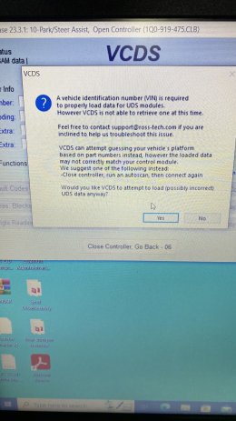

When i activate 10 park assist and try access it i get this message (i have attached the pic) and the settings on there i dont think matches my car. Not sure what the problem is

Wierd because it's not a UDS module as far as I know
Also you said this
But the scan says this
Part No SW: 7N0 919 475 A HW: 7N0 919 475

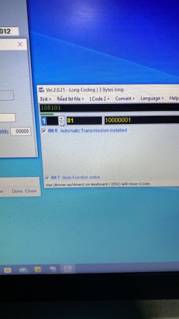

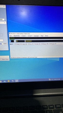

Ah damn i made a mistake and used the wrong module but im still getting errors. I have attached my latest scan with the correct module. Im thinking maybe its the sensors thats faulty? I changed some settings from automaic transmission to manual and changed the model to audi a3 5dr s line 8pa.

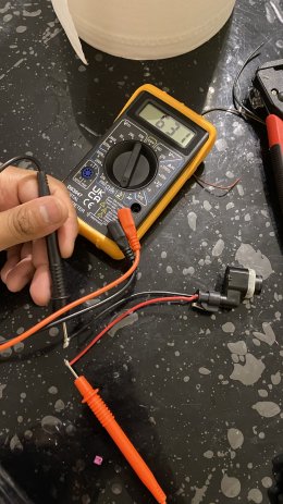

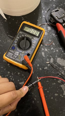

So i did this continuity test on 2 of my sensors using a spare connector i had, and i can tell when the multimeter beeps and zero displayed i have a good connection but with the sensor i dont get the beep i just get a reading of 630 or so. So does this mean my sensor is faulty? I have only tested two and i will probably test the rest tomorrow if you can tell me this indicates faulty sensors.
