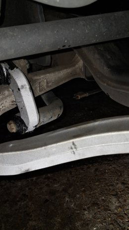

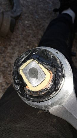

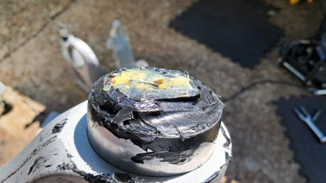

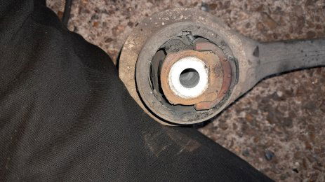

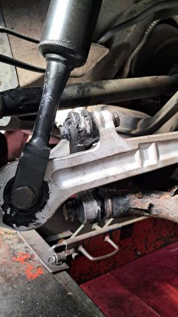

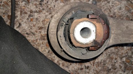

I managed to replace the rear lower arm and drop link on the drivers side but I cannot, for the life of me, remove the balljoint in the hub holding the other lower arm so will be ordering a different removal tool.
Also the bolt holding the tie rod end in cannot be removed either and I've used a lot of heat and hammering on both. This car is putting up such a fight in stopping me improving it and I also noticed that my inner cv rubber boot has split too.

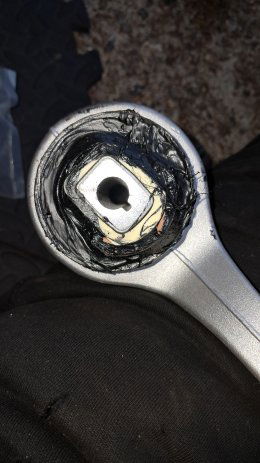

I also filled in the gaps in the rubber bushes with a PU 40 hardness to stiffen them up a bit, time will tell if it's worth the effort.

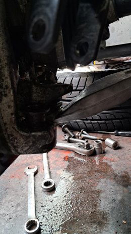

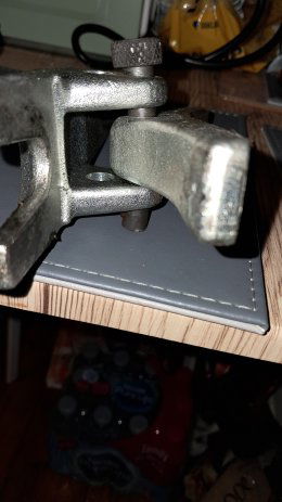

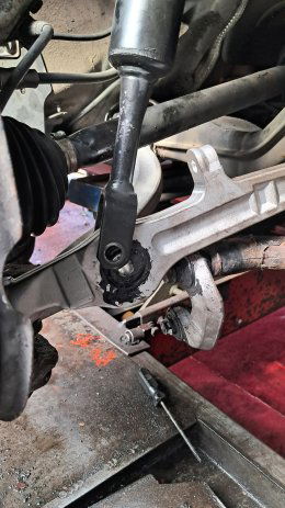

And another no joy evening trying to remove the balljoint from the hub.
The tools I got from Amazon didn't work and are being returned.
The one on the left, the removable 'hinge' in the middle started to bow and now has a slightly curve.
The one on the right the bolt seized when trying to turn and release it.
Another frustrating evening so I'll take it to a friendly garage and have them remove it.
*sigh*

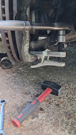

I'll give you a tip: remove the drive shaft, take the sledge or clump hammer and hit the arm in a save spot... it'll come out and take the inner bush with it... once the ball joint is out... take the arm off the car... put it in a vice and tap the inner bush of the balljoint.
Than using that same hammer tap it back into it's place.
No need for fancy balljoint splitters.

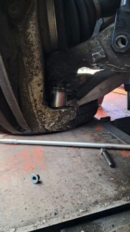

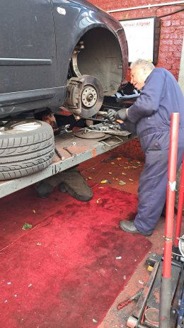

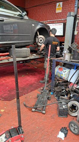

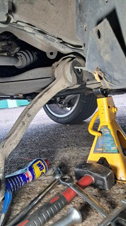

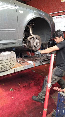

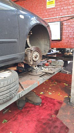

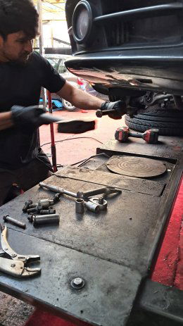

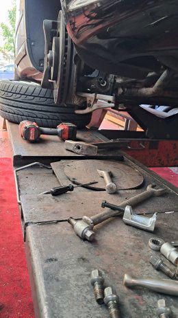

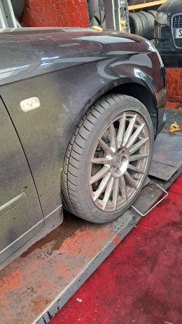

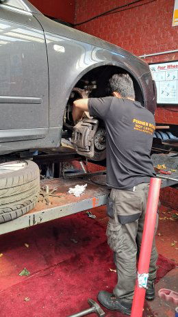

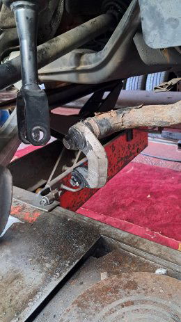

Soooo, I took the car to a friendly mechanic at the garage who said he'd charge me £20 to crack the balljoint.
3 hours and £90 later it was done and because it came out with the 'sleeve' the mechanic said he wouldn't be able to out it back as it is and would need to put the new one in.
This necessitated getting the bus back home get the new part, bus it back and have him replace it. In the end he needed a puller to push the balljoint out after removing the hub from the driveshaft and the new lower arm I fitted. Even then he had to grind down the sleeve at the bottom to allow it to get back into the hub before being hammered into position.
My only solace is that he said it was one of the hardest he had ever had to remove and some pics attached showing the pain.

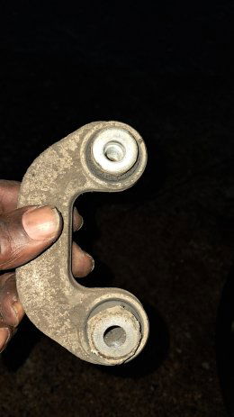

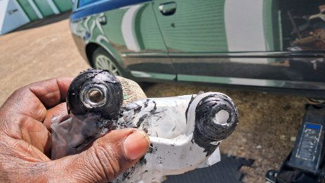

This evening, I managed to replace the other lower arm as well as the drop link in about 90 mins just using the pickle fork, some heat and lots of hammering.
Even with a very quick drive round the block it feels so much tighter, but it had to as the state of the bushes in the arm removed is so poor unsurprisingly. Pics attached of the mechanical shenanigans.
I've ordered a puller similar to the one the mechanic used to remove the balljoint and think I'll be able to do it so much more quickly next time. Still no joy with the tie rods but they can wait.
I did all the front end a while back and my bushes were totally shot after 100K miles, this was one of the better looking ones... :whistle2:
