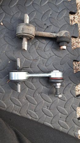

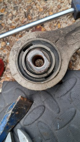

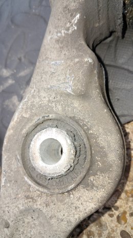

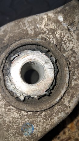

Its pretty standard bushing failure on higher milage B7's. :thumbs up:
It's normal on the higher powered models... my 2.0 the bushes were dried but not cracked like that some had play... so replaced them all anyway.

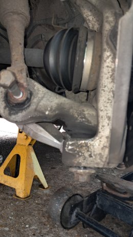

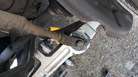

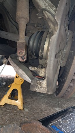

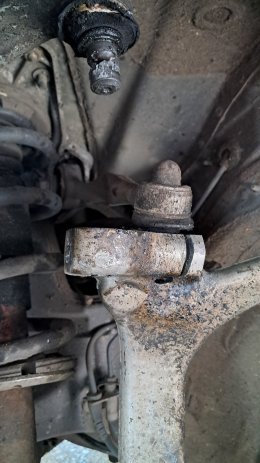

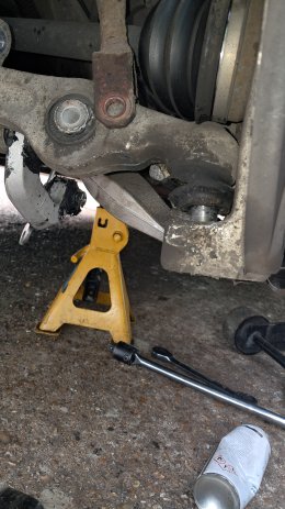

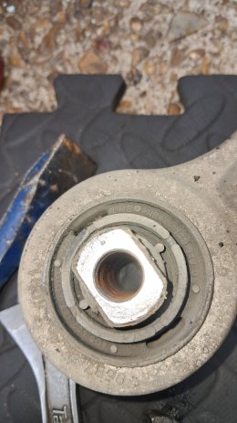

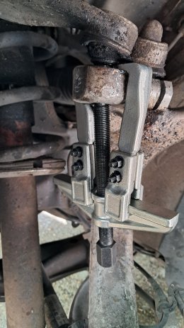

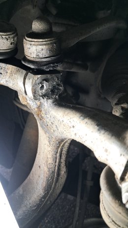

More joy today as that lower arm on the drivers side that gave me so much grief removing, the passenger side arm came out sooo much more easily.
I took my time, no heat and no balljoint splitter needed, just two good whacks with the same hammer I used unsuccessfully on the drivers side and it popped out. I didn't even hit it hard as I had noticed last week that the sump plug or sender was weeping so I decided to drain the sump and remove the sender then use a new copper washer on the sump plug and some sealant around the sender. And whilst I waited for the oil to drain out the hammer was to hand and I thought I may as well hit the hub. I must have hit the sweet spot as I didn't hit it hard at all and also I was at the wrong angle to give it a good hard whack.
Thinking about it now though I had used a one of these Sealey arm pullers from Amazon first but I didn't think I got enough torque on it as it started to slip so I had removed it, thought I'd drain the oil whilst I removed the other arm to allow the puller to get a better grip. So maybe the puller did enough to allow the whack with the hammer to work.
1727037073694
I started to feel that good I had a go at removing the infamous pinch bolt with some heat and grease and it started to turn as I had backed the nut off... but then it stopped turning and I knew the head of the bolt would shear off so I stopped, tightened it back up a bit and will try again in the morning after the gym. I now have a pin punch set so will shear the bolt off, use the nut to pull it through as much as possible then use the punches to hammer it through. I need to make the most of the good weather as tomorrow could be last of the warm/hot days this year.

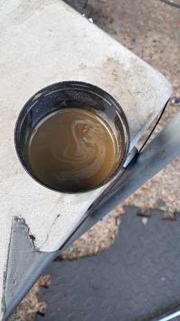

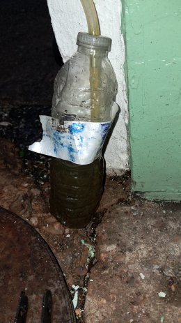

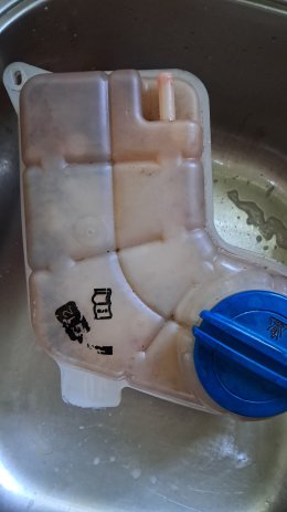

I also managed to drain the oil catch tank again of the gravy accumulated in the last month or two. There was more than shown here as the cap has a small hole in it which I only noticed when I picked it up and noticed a puddle on the bumper support and drops on the ground when carrying to where I took the photo. So much happier this being drained from the catch can than going through the intercoolers, the gunking up the inlet manifold.

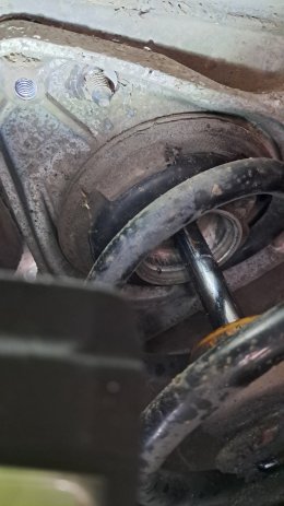

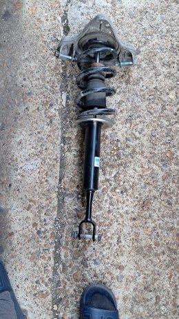

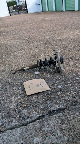

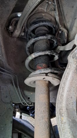

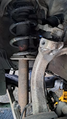

Today I bottled it changing the front shock as the weather was too unpredictable and so settled for changing the rear drop links which I found whilst rummaging in the garage for a tool yesterday. But with it being my garage and losing tools, parts and other things, I could only find the one so replaced it whilst I was still annoyed with myself. Weirdly enough I found two front drop links which I think are for my previous A3. And with the rear wheels off I took the opportunity to bleed the rears as I felt there wasn't enough bite from initial push off the pedal. Fluid was filthy. Now where is that other drop link???

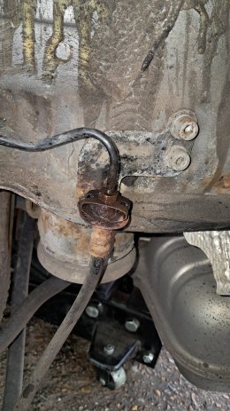

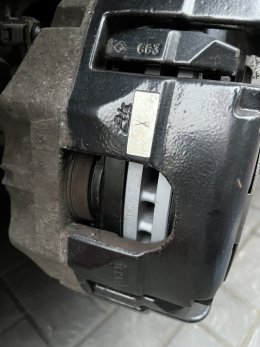

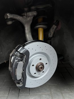

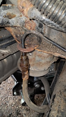

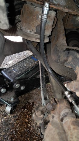

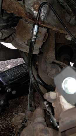

After bleeding the rears I still wasn't happy with feel of the brakes and was about to order some rear hoses when I realised I ordered a set months ago which surprisingly I managed to find. Got them replaced yesterday with careful use of the blowtorch to loosen the rusty nuts before using too much force and snapping the brake pipe.
I only realised when I did the second one that the retaining clip was missing which made it so much harder to replace.
So much better now these have been replaced, the old ones were woeful and had so much flexibility.
Also realise that I need to replace my upper arms too AND my driveshaft is getting noisy with that tear in the boot and, and, and...

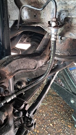

More joy...NOT. Well partly.

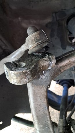

I managed to remove the shock but am still struggling to remove one of the upper arms holding the shock in place. I think I'm going to use the angle grinder to slice the into the offending arm which won't come out. Worse case scenario, I just buy another hub carrier as I'm starting to make too much of a mess with drilling the bolt out. Since I had to move the coolant reservoir to get to one of the top mount bolts, I thought I'd drain, remove ad try and clean the muck out of it as it's been bugging me for ages.
Shock removed and replaced with the new top rubber mount but still can't remove the upper arm. Let's hope I get it out tomorrow so I can just put the new shock in.

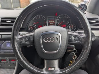

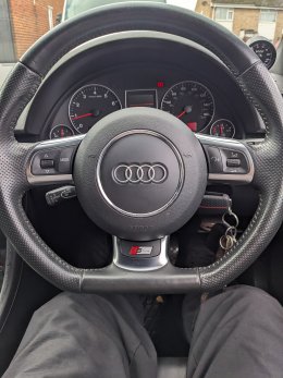

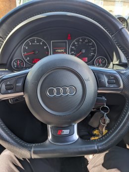

Fitted Audi TT Mk2 FBSW and airbag.
I used the guide on this forum, used a A4 B7 airbag loom instead of moving pins in the connector.
The only confusion about the guide was the 2 black wires, there are actually 3 tabs, so the wire that went to the ground tab on the airbag chassis
needs a larger female tag, (see picture on guide) but does not show the any wire connected to the Airbag tab.
I joined another wire on that ground wire and connected to the airbag tab.
I checked the TT airbag loom with a meter and the 2 wires are on the same pin, so did this on the A4 loom.
All fitted and working, no problems at all.
The only issue with this mod is finding parts in good condition, very difficult to find an airbag that looks good.
It looks like Audi cheaped out on the airbag plastic chrome, even the one I fitted a bit came off.
There are airbags with chrome ring, and black ones without, I wish I bought a black one now !!

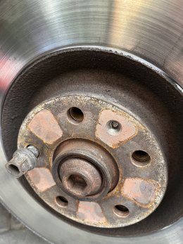

Noticed a few black grease blobs on my nearside front wheel, closer inspection has revealed a split outter cv boot again, that is another Apec failure in less than 12 months.
will be having a serious conversation with them on monday thats for sure.

Finally got around to replacing the front brakes today after battling with the rusted carrier bolts. The rears are a doddle compared to the fronts, but the calipers really could do with a refurb.
Reactions: northpole
The previous owner had also sheared one of the rotor retaining screws which i've not been able to rectify yet.
Reactions: Charlie Farley and northpole
I have yet to run into a car at these ages that doesn't have at least one of the disk locating bolts sheered off... I haven't sorted it on my car either, I'll tackle it next summer.
Reactions: Charlie Farley and Jamestnewson

Turns out on closer inspection to be both sides again.
I've had a pointless conversation with Apec today, they know there is an issue with A4 B7 drive shafts they supply but don't want to admit it, anyway, the shop I used has sorted it out and organized a full refund so I'll be looking at something else 3rd time around.
Don't even go near them without some heat first then a Vessel impact driver, not been a problem for me thus far using that method, but agreed they can be a pain to get out otherwise.
oww that isn't the problem though... it's when you go to replace your brake pads or driveshafts, when you actually notice that the darn thing has a sheered off brake disk locating bolt. It just means more work that i couldn't be ***** with at the time i noticed it... and frankly forgot about until i saw that post.
Note my reply: I bought my car like that and it'll stay that way until next summer. I got those brake disk locating bolts as spares in my tool box anyway.
