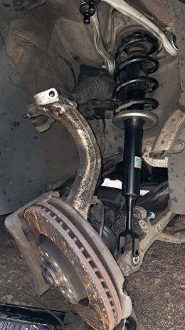

AAAAAAAAAAAARRRRRRRRRRRRRRGGGGGGGGGGGGGGGHHHHHHHHHHHHHHHHH.
Eight and a half hours to get the pinch bolt out and still the upper arms won't pop out even with the hammer.
Started at 10.30, stopped for lunch and to watch the first half of UTD - Liverpool then back out and stopped at 8pm.
Play will resume tomorrow.

Yep, sounds and looks a normal situation to be honest.
did you get it out or still locked in battle with the bolt?
Reactions: northpole

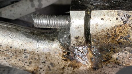

That last picture shows what was left of the bolt after heating it up, drilling it (burned out my cordless drill doing this too) using a hand held grinder and then switching to the big boy to cut the bolt down as I used the nut to 'tighten it' and pull it through. Wasn't sure the tears were from joy, relief or that I wasted one of the warmest days of the year over a bolt.

Yep, the bolt came out finally, I'll remove the tie rod for the steering this evening after work which should help.

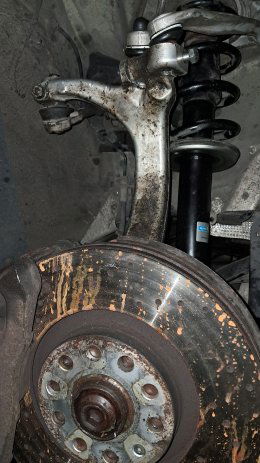

A modicum of success this evening as I managed to remove the strut and replace the shock absorber.
But I couldn't remove the tie rod end and the right hand arm couldn't be removed either.
I'll be purchasing a drift set and anther pickle fork as I broke that as well trying to remove the top arm.
In the end I removed the three bolts at holding the shock in place and the drop link allowing me to drop the shock enough to release the bolts holding the arms to the top mount.
Every bush is worn, torn or loose and I'm now so glad I've bought all the arms and bolts to replace.
When I removed the old shock I compressed, 45 mins later it had barely risen.
With luck I'll have this done by Wednesday...

@ttelracs I know how frustrating the top suspension arms can be.... but with the shock not coming up be assured in the fact that you did the right thing... mine in the front are still good, the rear though.... well they are dampening but they are tired... the reason why i know is simple... the stuff i have in the back isn't heavy but heavy enough to visually drop the rear (reverse rake) so time to replace them... but live has chucked a spanner in the works, so it'll probably be done later this month... that is if it stays dry for a few days on end. But I might have it done, can't really have the car out of comission right now.
Yep, agree 100% with @northpole . I'd been putting it off for months and know it'll be oh so worth it when finished. I did my rears a few months back, sooo much simpler and straightforward. If I don't get this done soon though it'll be getting in the way of life.

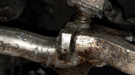

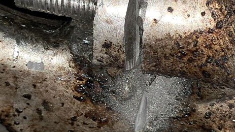

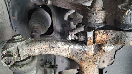

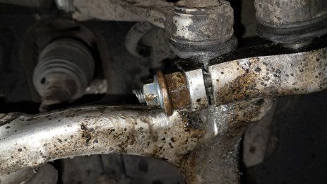

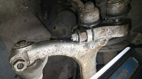

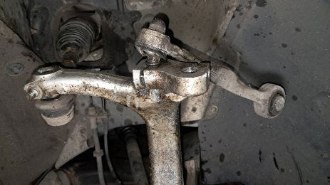

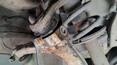

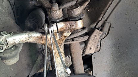

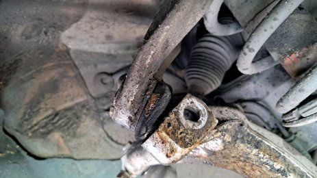

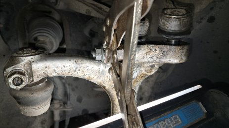

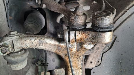

Progress with the front shock four steps forward, one step back.
When I hammered out the top arm on the left hand side I had to use a drift but I didn't realise that I marked the hole with the drill bit when drilling out the bolt... I couldn't get the arm properly seated. After realising my problem I used a drill to smooth it out and a flap wheel to take a little material of the knuckle which worked. I got it seated but getting the bolt back in was tough so I screwed it back in. The big problem is that the bolt isn't the strongest and so the thread wore down meaning the nut now no longer will go onto the thread. I'll need to use a die to retap it and I think the best solution is to remove it, take a bit more material off then reseat it. Ahhhh.
The last image shows the bolt not properly seated but I'll tackle it tomorrow.

that part with the slit in it is out of line (read to wide) causing the problem.... i ran into that and in the end that is what broke off... ending up replacing the complete knuckle because of that..... be carefull with it and try not to shave off any material. Plus how those top arms are held in place you need to push them all the way in before pushing the bolt in place... otherwise they'll strip it.

THANK YOU.
DONE. Thanks again for the advice @northpole as I used a blowtorch to heat up the area and a clamp to squeeze it just enough to close the gap slightly. This worked and along with a new M10 bolt grade 8.8 and using the same clamp to ensure the arms were seated properly all good. I thought I took some more pics but must have forgotten as it had just started to rain and I was keen on putting everything away. And yes, it feels firmer and so much better, can't wait to tackle the other side... NOT.
