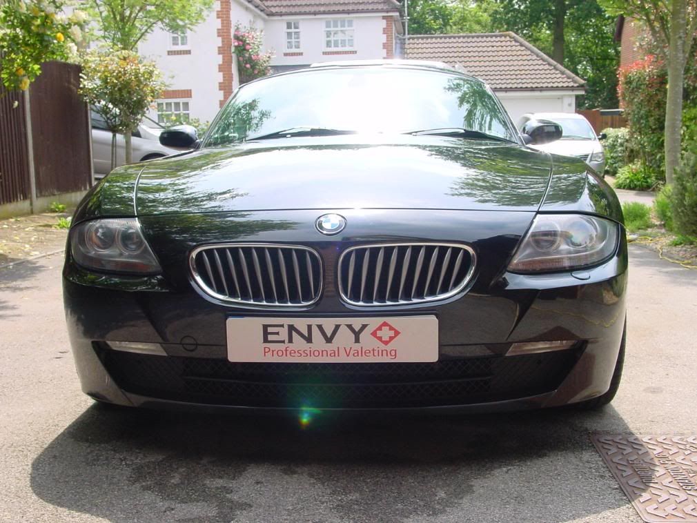

Final detail today from a busy week. Last one I promise for a week. Its half term and I'm going to have a rest!
Looks pretty acceptable but generally lives outside
Wheels washed with AS Smart wheels and EZ detail and trusty Envy brushes
Body foamed with Activo foaming tfr and arches blasted out
Rinsed off, looking better already
AB SSF
Washed with TBM, Z sponge and the usual grit guards. Rinsed and dried.
Clayed with poly clay, the machined with Dodo Juice lime prime lite on the good bits and lime prime/Menz IP on the fly spattered areas that resisted claying!
And buffed
Bit of wet sanding via PC on the rear scratches
Once over with the rotary and MarkV Mystique
Bonnet wearing a coat of Saphir and allowed to cure.
Exhaust cleaned with Autosol and fine wire wool
Interior leather given a wipe with a damp cloth then tested my Zaino Z10 sample
Smells great and looks like this as its absorbed (easily too)
Tyres were dressed, glass cleansed. Plastic washed and protected with Espuma Dasheen.
Here are the afters once the Saphir was buffed off
And finally
