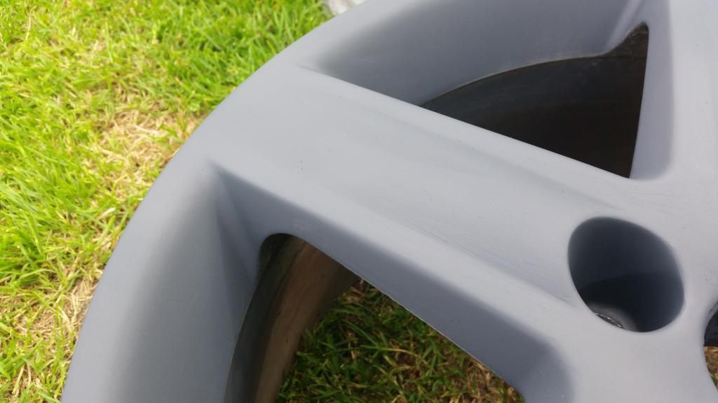

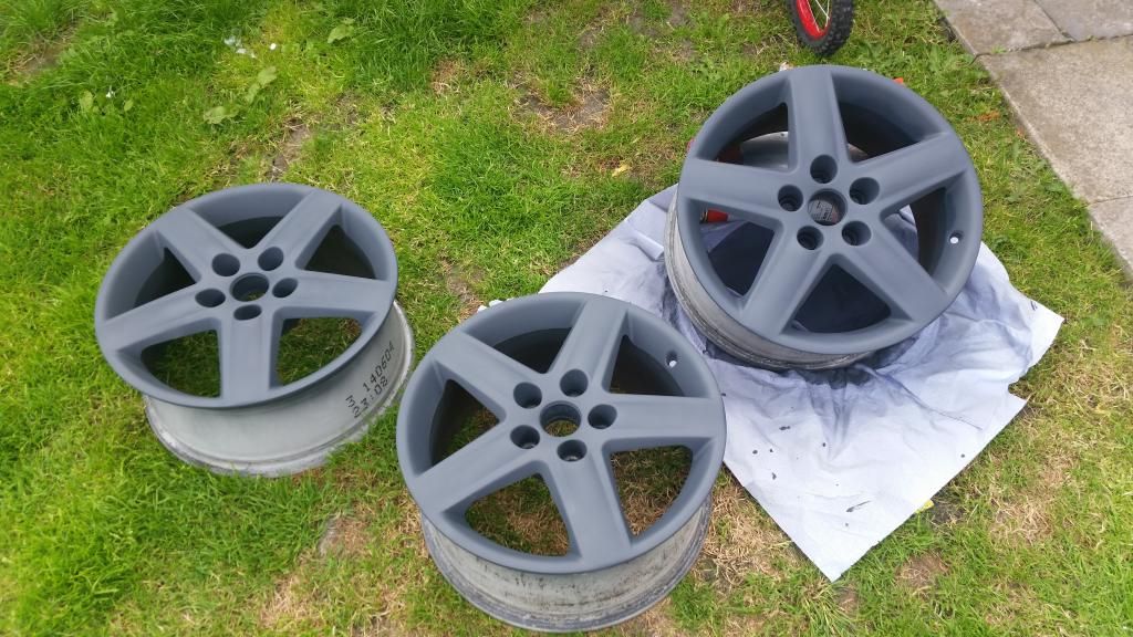

Three wheels sanded back, etch primed ready for Black Satin paint:
U-pol Etch Paint

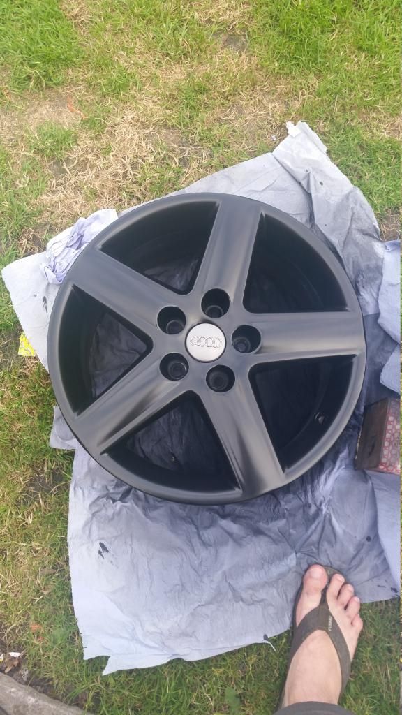

One wheel with the paint finished, awaiting lacquer:

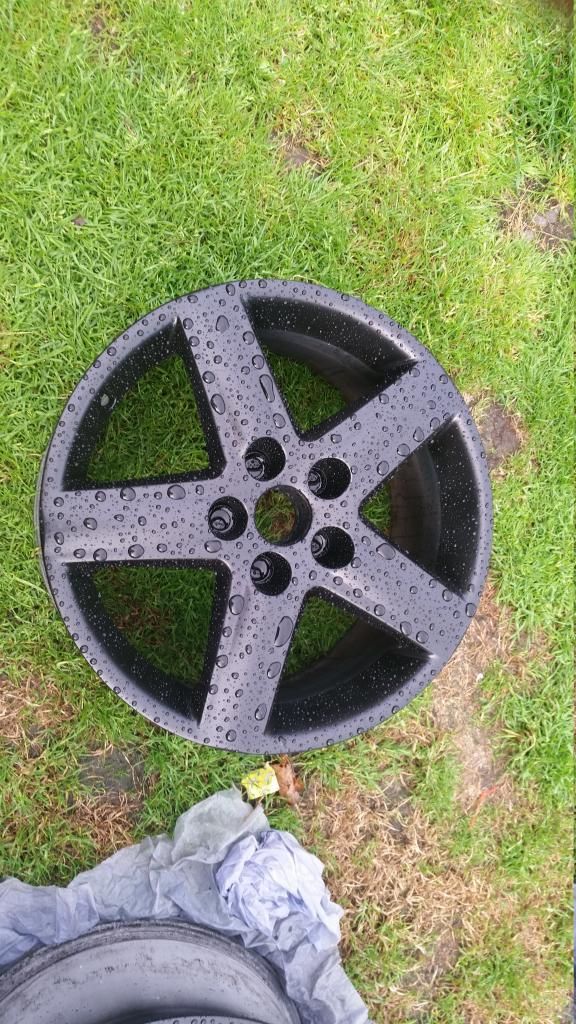

Without clear lacquer after it rained:

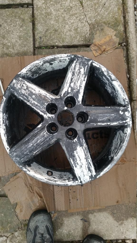

This wheel is a swine! This was the only wheel to have been painted semi correctly! It has a primer and a very thick glossy coat, which even with Nitro-Mors paint remover, it is struggling to come off!
