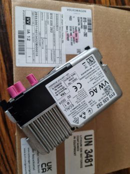

My dealer kept putting me off, saying they needed to replace the Online Connectivity Unit, and the part was on back order. I was very sceptical as the recall stated it was just a software update. They eventually got me in, and they did change the unit, as they left the old one in the passenger footwell (perhaps to prove they had changed it), to do that, the paperwork said the MMI had to be removed.
I've attached photo of my old unit.
