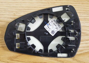

part no for glass is:-
Drivers door mirror glass reverse
