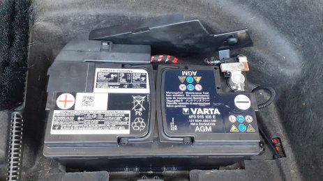

This is what’s currently fitted.

I've been having problems with my battery on my avant lately also, haven't had the car long.
The stop start hasn't worked since I've had it so I thought I'd check what was fitted to mine. Turns out there's only a 70ah battery fitted and isn't AGM. My sticker says 'J0P' which is supposed to be a 105ah 580a.

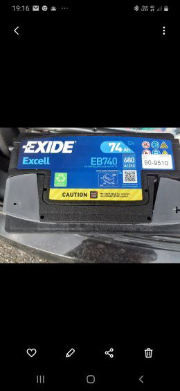

I have Audi A4 b8.5 with start&stop. I bought new battery, manufacturer EXIDE without AGM(start&stop?). Car has original battery, varta 4F0915105E.
We have coded that start&stop don't work.
We installed new and tried to code it.
We write to vcds 4F0915105A code, because it has varta 74Ah model. But didnt work? New exide is also 74Ah. I didnt find exide serial number?
Attached new and old battery

Not sure what you are asking here. Change 1 digit in your existing battery coding and the car will recognise the new battery.
Reactions: audiwaterpump
Yes only changed last digit.
But is that enough? Or what we should do it to register new battery?
Yes it’s enough as your new battery doesn’t have a BEM code
I think the code what we wrote is agm code because we change only last digit? Few message earlier I send photo. What is exide serial number?
The actual serial number of the new battery is not important, and most aftermarket batteries will not have a serial number on them, only a production batch code identification.
So you fitted a standard battery to a car that has regenerative braking and stop/start, I'd doubt if that battery will live very long when it gets force fed by large/heavy amounts of charge by the car's charging system, this type of car should always be fitted with an AGM type of battery, EFB would work but for a shorter service period.
