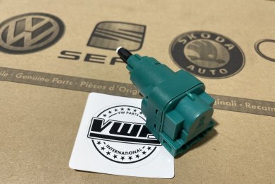

the last problem was the brake switch:
the early golf 4 has a 2 wire brake switch
so i had to upgrade it with a 4 wire switch (green one)!
then i routed other 2 wires to the ECU for the brake signals!
the clutch wire was already wired!
so at the end for retrofitting the cruise control on my MK4 golf GTI with AGU engine i did those steps:
- Replaced the stalker with the cruise control version (like on the DBW retrofit guide) and connected his wiring and routed part of it to the ECU
- Replaced the engine ECU with a Cruise control one
- Replaced the Throttle body with the vdo with code 06A133063F
- Replaced the throttle body connector (or remove and re-pin it correctly)
- Replaced the 2 pin Brake switch with the 4 pin version
