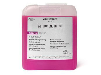

can anyone tell me how much coolant the B9 RS4/5 takes when drained down? i’ll need to order some to refill this one the intercooler has been installed. G12EVO i believe is the latest.
Tbh I use a 50/50 mix for all cars, unfortunately shady as it is, Audi are doing a ready mix now which is basically the same price but half the actual liquid so to speak, it used to be fully concentrate, but you could still get away imho with a watered down solution as it's good stuff.
Grab 3 bottles try a 50/50 & see how it works in diag temps.
It was g12, then g13+, now afaik it's back to a g12 of sorts, it keeps changing but imho it's all the same stuff, if you can get the concentrated then split it across 2 bottles.
Very underhanded by the germans. As you say, you used to be able to by a gallon of the G13 concentrate for the same price that they sell the 50/50 mix now. Crooks!
Yeah not cheap stuff. Still not sure what the quantity needed is for a fully drained system so I’ve got 2x 5L pre mixed G12Evo which is the latest VAG stuff.
I Hope these will be enough or I’ll just add a bit of distilled water.

Its not really the same stuff, it is mostly down to the silica levels, early stuff had too much and caused problems, so they took it out and it caused other problems, then they put a bag of the stuff in the header tank and that caused problems too.
How many people do you think use the correct distilled water to dilute the coolant? Evidently some 'waters' did not play well with some of this coolant either and caused more problems so going ready mixed is the obvious way to go most have now gone that way. These modern coolants need to run at a fairly specific concentration and people are always tempted to stretch it.
Direct from Audi
IMPORTANT! Mixture ratio must be observed:
› Not enough coolant concentrate  danger of freezing, corrosion, and boiling.
› Too much coolant concentrate  danger of overheating.
Not as you would think but these modern fluids do not behave like you would imagine and some engine bits like the modern oil (to water) cooler are a bit more picky.
AFAIK post 2019 it is now ready mixed G12evo and no "mit silicat" tanks.
I have no doubt they added a hefty margin to it, like everything else with a VAG logo but I understand it is expensive stuff to make and it is another way of passing on the costs without people noticing (think Toblerone :grumpy:)

Approx 7.5L of premixed G12evo coolant ‘sucked’ in with the vacuum filling tool, ran up to temp with no issues.
