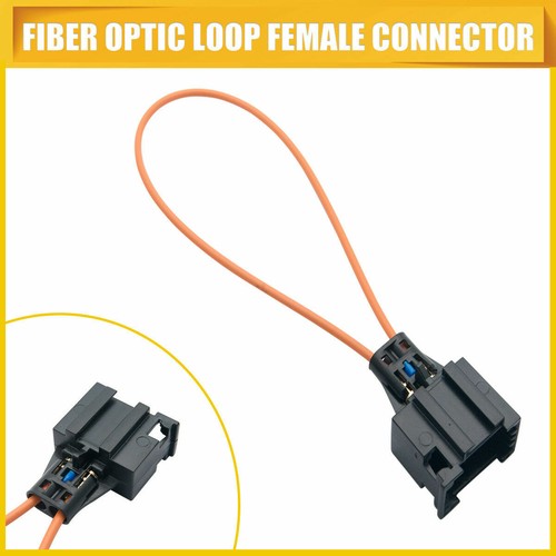

MMI 2G phone modules are well known for going kaput, especially on that age of car, get an MMI loop and bypass the phone unit under the passenger foot well in the large plastic box.
Also, does your rear washer still work, the reason boots get wet in the cubby hole is the pipe going through the boot hinge cracks and water no longer travels to the washer but ****** in all over your MMI installation in the rear cubby hole.
If it's dry there and there is no white powdery residue on the amp, radio etc and your wash wipe still doesn't work then check under the floor of the front passenger side where the phone ECU is located, unfortunately Audi fitted a joint there for the rear wash wipe and I have seen (only once) this pipe come apart and flood the floor pan on that side and kill the phone ECU, but I would think that the MMI would be totally dead if this had happened, but it's still worth checking under there and bypassing the phone with an MMI loop.
This is what you would need to by pass any part of the MMI.
