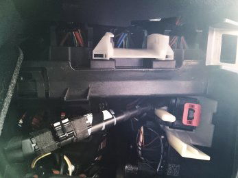

Hi all - first post in a while. I have an A3 Sportback 40 TFSI e and recieved this letter yesterday. Thanks to 8YARWY for the information, especially the .pdf I've had a quick look behind the panel but it looks different to that shown above - it's all black including the cables which are tightly tucked and routed. There doesn't seem to be any cables you can tug to check if loose. Is my model different?
It's just that the dealership is over 50 miles away and as has been said already it'll take some time to get it seen to. My next service isn't due until next year.
Just had a look at mine, looks different to the pic above though
IMG 0461
Yes of course I took the trim off but like Dnwc mine is different again. I just didn't get my head right under to take a pic which is now attached
Hopefully someone would explain what to check please :)

Just checked
This is the connector with the red tab
If it’s extended down to the floor it’s not in the locked position, hence Audi concern about it not being plugged in correctly
Put your thumb on it and push upwards if it’s in the locked position it’s fine and won’t move
Reactions: Kevmoz, cooperp and RS03???
Just checked

There’s no fault, it’s either not plugged in correctly as above in the many pictures / how to check it yourself, or it’s plugged in and the red tab locked down.
It’s the main supply to the fuse board hence a need to check that multiplug is in and locked by the tab.
Takes minutes to check nothing else.
