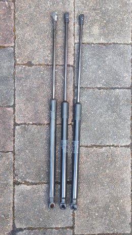

I just went to visit the S3 and treat it to some new boot struts only to find they don’t fit perfectly. So, now I’m wondering where people have obtained replacement boot struts from in the past for theirs?
My boot struts have been long overdue for replacement and I ordered a set from SGS Engineering for the 8L. I just fitted them and they extend slightly too far. They fit fine, but the boot lid now opens higher (or further up than before) and the boot spoiler fouls the aerial. Spoiler and aerial are totally original/standard. I have contacted SGS to arrange for a return/refund.
Before:
After:
In the meantime my local Audi dealer has said the original struts for the A3/S3 (8D9827552H) are no longer made. Typical.
I found the following online which match the part number. Has anyone fitted or used these before? Is it possible to have the original struts reconditioned? I don’t even know if that’s possible but just a thought.

The one's in the last pic look good to me part number ending in H rather than F or G.
Sent from my SM-G975F using Tapatalk
They’re the originals in that pic that’s why ;-)
If I put one SGS strut with one old strut, I get slightly better lifting, and the other strut stops the boot opening too far, so that could be a winning combo.
I might try those others from strutsdepot.com. They advertise hassle-free returns also. If that’s the case then maybe I’ll just keep the originals on. They still work and hold the boot up, but they’re definitely weaker than a brand new pair.

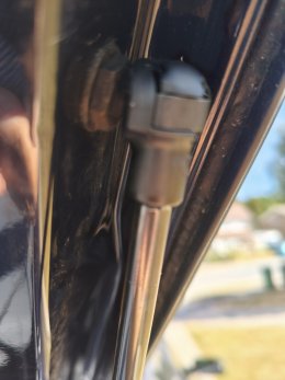

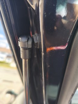

I have attached a coupe of pics where the top struts are sitting. They do not look flush against the boot - looks like its sitting unevenly. Is that normal?

There are two different types of original available the ones you need are part number 8D9827552F I will send some pics to show the seating position all the best @MPH
