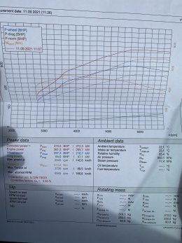

Hi chaps.
Just had my S3 tuned on the dyno by Mallory Performance and I have to say if the car put a smile on my face before now it’s even bigger.
On thing that caught my eye was on the base run to see what the car was running stock it came up as 322BHP! I was expecting this to be around 306-310 or even less give Ive had it since 2017. According to the guys, majority of these car run higher numbers stock than what Audi claimed them to be! They’ve seen a huge range of stock BHP numbers in the Audis they worked on even their development car was running higher to what was claimed.
Anyway car is now sitting comfortably at 370bhp at stage 1. The guys did a brilliant job with the map as the power delivery is nice and smooth through the gears unlike some others that I’ve been in which just spike and drop down after a few gears.
Would definitely recommend these guys.

Power readings fluctuate between different dynos, maintaining, calibration is of course detrimental, I would try a few other dynos for comparisons to get the best average.
I would say that as long as your butt dyno is loving the extra torque and power who cares. 370 sounds about right. it would be worth at least putting in a performance panel filter (40 quid) and if you feel inclined the OEM intake mod listed in the FAQ section. Makes the top end feel a little brisker even on a stock car.
