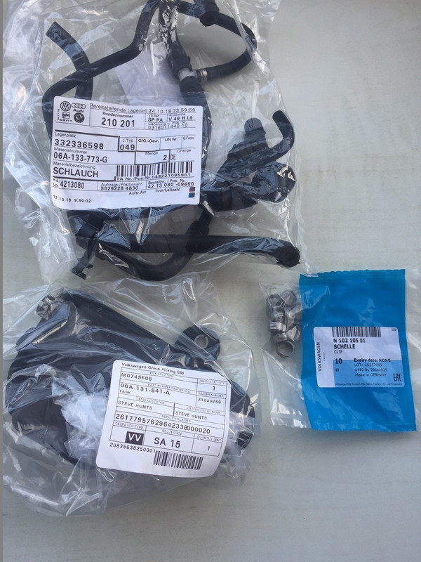

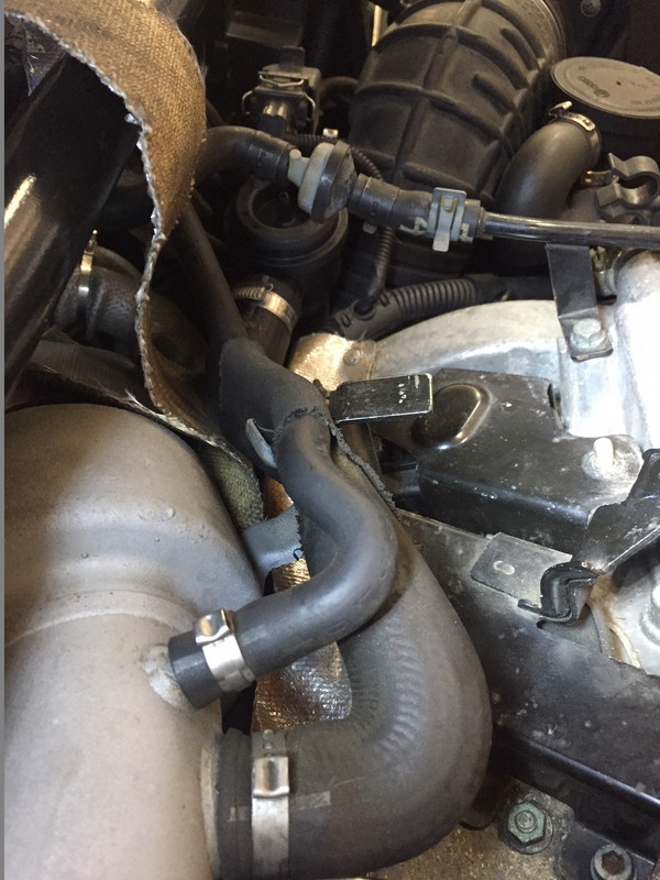

I have a standard 2002 S3 BAM which i scan every couple of months for codes and is always code free.
I did a scan the other day and got fault code 17608 p1200-35-00.
I cleared the code and went for a short drive and the code was back.
I changed the N249 for a new one and checked all my hoses, cleared the code and went for a drive only for the code to come back.
Today i have replaced the oem DV with another new oem DV, cleared the code and went for a drive but the code keeps coming back.
The car drives fine and the eml is not on, can anyone give me some advice on what logs i should be doing and what block numbers i should use?
I did wonder if i might have a map sensor fault?
