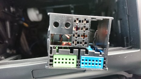

Found a really helpful motorist shop near me he took my existing head unit out to look at the back of the Quadlock wasn't sure which one to order so rang his supplier ordered it in explained I would have to plug the front and rear speaker plugs into the back of my pioneer unit just plugged it all in just loosely to make sure it was the correct harness and it doesn't work the part number on the harness is Celsus ISO Lead AIS2265 hear is a picture of the back of my Quadlock and the Celsus lead
That is the correct adapter, you just haven't connected it up correctly
The RCA's connect to the corresponding front and rear RCA's on the Pioneer
The blue flying lead on the adapter connects to the power antenna or remote on feed from the Pioneer
And lastly you need to provide a second switched live feed to the Pioneer as there is only a single permanent live on the Audi loom. I'm presuming that's the long red wire in the pic. This needs to connect back to the fusebox for an ignition on feed or you can just pair it with the permanent live already on the Audi loom but then you would need to turn the HU on/off manually. I seem to remember the AppRadio stupidly has no on/off option so you'd need to wire it back to the fusebox.
Hi Andy
thats a relief it's the conect adapter, I know I have to connect the long red wire to a live, I was hopping to connect it via a relay under the steering column as you posted on hear, I found it whilst doing a search before I asked my question, is this possable to do with the Appradio2?
When I say I conected it up and it did not power up the long red wire I connected it to the blue flying wire for the anenna I kind assumed that would give me live just to see if it powered up to make sure it was the right adapter, when it didn't work I looked at my oringernal quadlock and there are only six pins in the block but the adapter has only three and the bottom right pin on the adapter is black so I am assuming ground but the corosponding pin on the cars quadlock has a fatish brown wire which gave me some dout is this still right, and finally the orange wire which I need to conect to dim the backlights where would be easiest for to to splice in
Brown is earth in an Audi, so that is correct.
If the HU isn't getting both 12v feeds then it can't turn on so it can't give you 12v on the power antenna feed, which means it can't turn on - catch 22. Just connect it to an ignition live and it'll work
Thanks Andy once again lol
brown is earth? Pesky Germans, I can see you point about the blue flying wire not beeing live without both live feeds nice one mate cheers Paul
View attachment 14103View attachment 14104
