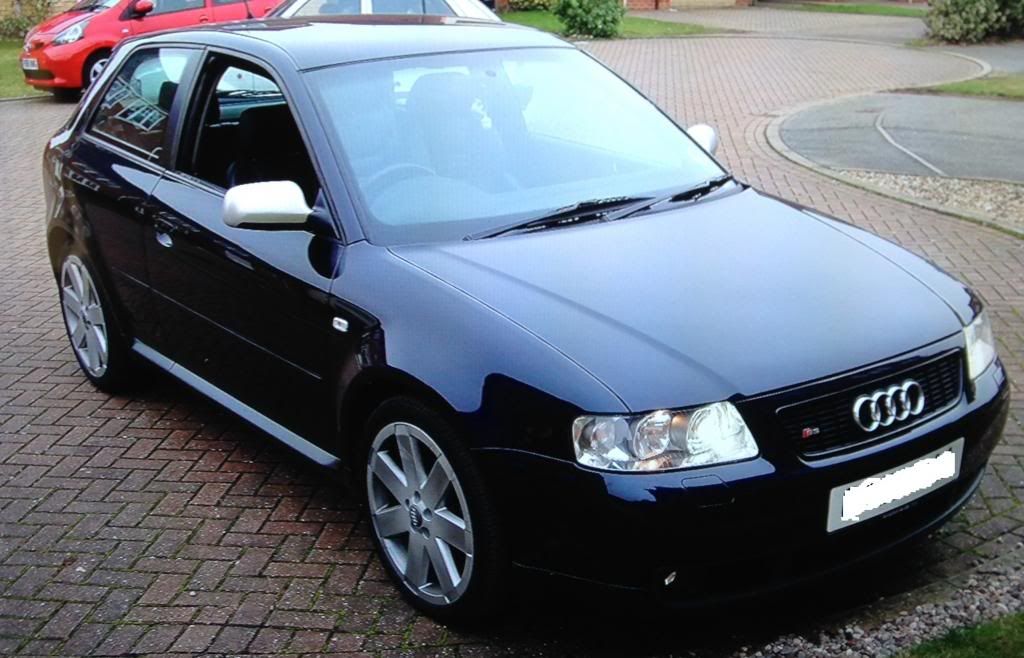

These pics are of a forum members S3: -
Uploadfromtaptalk1395180171818 Uploadfromtaptalk1395180193809

Yes thanks mate. That is the only car I could find online with them on too

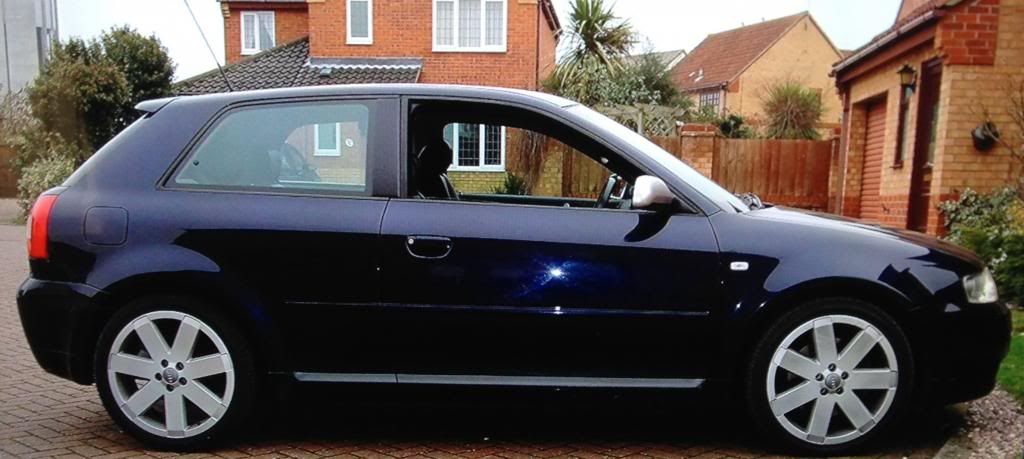

I have got some pictures somewhere, I'll do my best to hunt them out !

There you go, they look alright actually...
think I only ran them for about 3-4 months before putting the rstts back on.
Would have looked better if it was lowered I reckon.
Yeah definitely jo,
Think I might of just had the car jacked up before these pics cos the camber looks dodge !
