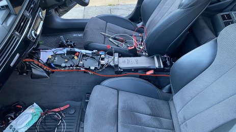

  • Start laying wiring harness, starting at the rear and making sure you leave some slack
    • Routing follows the "transmission tunnel" under the carpet where possible (long sticky thing is useful here) and up into the dash
      • See picture (red line)
    • Use harness tape to secure the routing and make it look OEM
    • Once you've tucked this up into the centre console you can route it up over the MMI unit and over to the fuse box
      • Use harness tape to secure to dashboard area (the main harness is tucked too far inside the dashboard to route with the harness)
    • Secure the fuse terminal into the fuse box. I found an empty fuse slot and added the harness into it (my harness was too long so I cut it to size and used the a new fuse terminal)
    • The grounding spot can be anywhere with uncoated structure near the fuse box (if you make your own harness or fancy stripping the harness tape off the supplied harness, you can ground it at the red dot)
    • Install fuse into holder, I used 10 amp
IMG 8532 1
