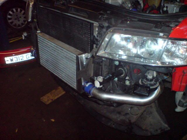

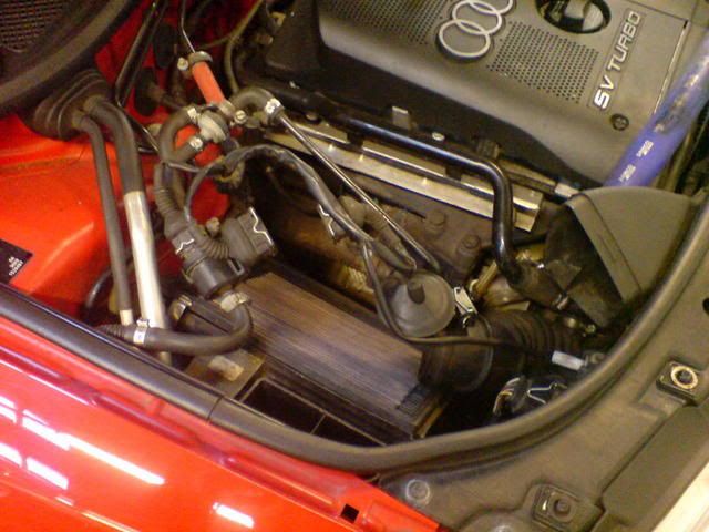

Also fitted my fmic. Ran into a problem as I have moved my DV but sorted it.
Here is the section on the bumper I had to cut.
All done.
Cant see it that much which is what I wanted. Would have rathered it be black but I am not that bothered.
I am also holding 2psi more now and can hear the turbo a little more. I dunno if this should be the case or what??

Very nice but gaining 2 psi don't think thats right I can only think you had a leek all this time and the new FMIC got passed the leek.

Ahh just seen the script on the blue pipes it must be a Autobah88 kit nice.

You could really do with an S4 or RS4 style bumper to expose more of the intercooler. It won't be able to work very efficiently with such a small area exposed to the air.
Dan Gliballs
Jul 5, 2006
1,566
Agreed.
There only looks to be barely a third exposed there.
Stealth is a great thing, but unfortunately in the intercooler world it's tot the BEST ethos for getting the best results :(

Yeah I dont mind if its not working 100% to be honest. I like the standard front bumper and want it to remain stealthy. It seems a lot better than the old side unit as it is.
Its the cheap Autobahn88 kit I bought. Good kit apart fron had to redrill the brackets, so no big problems.

How about cutting a discreet slot above/behind the reg plate?
Could get a wee bit more air to the top and still keep the Q car look.

Yeah the cut behing the number plate may be a good idea.

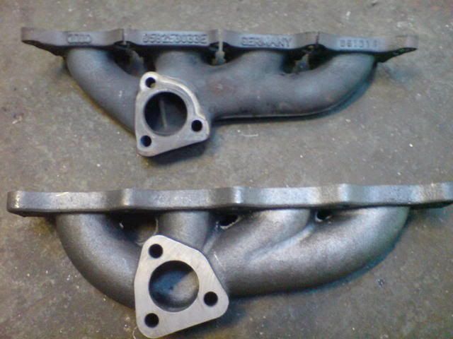

Hey folks finally got my 034 manifold fitted.
Was easy to get the old manifold off but hard to get the new one on as its pretty chunky.
It took me about four and a half hours to get it done in the end.
Has made the turbo super loud above 4k revs. The old one must muffle the noise a bit.
Here are pics anyway.
Old on
Old off
Some comparison shots.
Old outlet
New outlet

some good work there mate the manifold you got is the same as the one i have on my car but i got mine from THS who imports these from the company who makes them for ATP and 034
i know what you mean about it being a ******

BillyBravo how did you fully tighten all the bolts on the manifold? I have done mine as tight as I could but could probably do with getting them tighter.
I was thinging of bending the neck of a spanner??

i think that is what i did mate the one at the end of the head near the fire wall is the wrost
