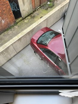

Bit of a test for the old girl this week, trip to Northern Ireland for the honeymoon. Everything’s been sweet really, no problems. Usual loss of power steering fluid, but we’re aware of that so just top it up. Need a new power steering hose really, hopefully resolved next week or so. Didn’t see 1 other B5 in Northern Ireland at all.
Was even able to keep my eye on it in the hotel room too, lol.
