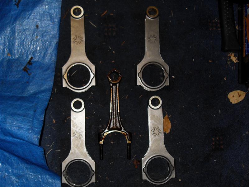

When I found the cause of the problem was a bent rod, I asked myself was it worth fitting standard rods again. Bottom line - it's bent one. This means it can bend another one. The standard rods in the S3 engine are *****. Why why why would you build an engine with a forged crank, and forged pistons, and then join them together with rubbish? If standard rods from Audi are £41 each, and you are considering replacing all four, then it's only an extra £100. Plus then you'll need to buy big end shells for them (as you would anyway with standard rods).
I chose to cough up the £300 ish quid for IE Rods from Badger5, and I would suggest you do the same.
OK - extra spend I grant you. BUT (and this is a big but) how would you feel having all this work done, and then bending another rod, and then having to go through it all again.
That was my thought process and £300 for piece of mind was £300 well spent.

A little is acceptable on a turbo engine, I suspect it's likely to be turbo related smoke.
Yes I do personally think it's worth replacing them. IE Rods are forged rods - see picture below for comparison with standard.
You'd have to drop him an email or call him. Contact info is on http://www.badger5.co.uk/, however I have dropped him a PM to have a look at this thread so he may well post.
hell they look a billion times stronger than OEM rods, would definitely consider this now. thanks for the quick reply too Welly.
