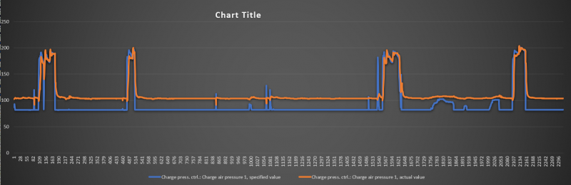

Got the Issue P256300 - Turbocharger Boost Control Position. Firstly I thought is the turbo actuator, but I changed it for a brand new, calibrated and the issue remains the same. When I turn of the ignition the EPC light goes off, and when I drive without hard acceleration the EPC light does not reappear but I know the issue is there and I don't need to press the pedal that hard to see the light again.
After that I've read that it could be related to turbo generally, and someone with simillar issue had it sorted and it was a turbo leak. Did a test using OBDEleven and for me it seems fine, but perhaps any of you can confirm?
If that is not turbo leak, does any one has any suggestion how to proceed forward? The car runs fine, no limp mode, no loss of power.
