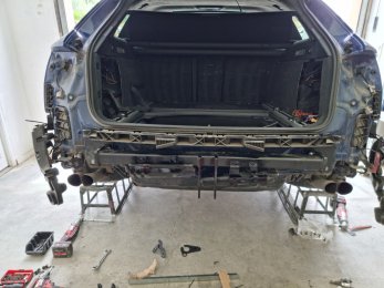

Is there someone here that has done it and also is there someone who has a picture of an RS6 with DRC and without the rear bumper to see where those bottles are exactly ?

just had a look under the car, you can see the DRC and they are behind the bar but fixed on it, probably need to adapt them

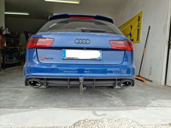

Hi, just to keep everyone on the loop, I managed to get the towbar installed on my RS6 with DRC
To answer any questions : I'm in France and I just want to put a bike rack on the car.
Couple of pics :

Salut, je ne sais pas trop la marque de l'attelage mais ils ont du utiliser un attelage d'une marque et un crochet d'une autre marque pour que tout passe
Hi, I don't know the towbar's brand but they had to use a brand for the towbar and another brand for the hook to be able to fit it.
