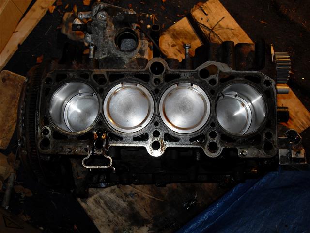

    New lump totally stripped, everything swapped over. Happy with the clutch, looks really good as does the flywheel.
    New engine has been stood for a while. Oil was NASTY! Taken all parts that I can swap over, but after 1000 miles I thoroughly intend to flush the engine and change the oil to get rid of any lasting 'old oil' nastiness.
    New con rods, and shells arrived (Thanks again Bill - legend ). Pistons went on the rods fine, and then into the block. Gave one of the oil squirters a nudge, but a gentle push with a flat head screwie put her back where she belonged! What a pain though!
    Head is back also - looking immaculate. SAI blanking plate from Forge fitted as well.
    Ready to refit the block tomorrow...
    Photos:
    Engines during the parts swap
    AGU head *cough* for sale *cough*
    Head back from A&M. Top job they've done for Ł150, 100% impressed.
    New block, water pump fitted, no pistons though....
    New IE rods. Out with the old, in with the new.
    Ready to go into the block....
    Lost the will to take photos after this.
    Tune in for tomorrow's exciting instalment.... lol.

    Well, the block is in.
    What a NIGHTMARE. Got it up to the right level at about 6 PM ready for it to just 'slot' on.... Then spent 4 hours kicking it and moving it about trying to get it in. Made hell of a mess of the inside of the bell housing of the gearbox (flywheel teeth grinding) so there was filings all over the joint!
    Anyways, after 4 hours of fiddling about trying to rough it in we decided to stop (not having ANY joy) and go back to basics. Pulled block back out, and dropped to the deck. Checked the clutch plate alignment etc etc, all fine. Cleaned the filings out of the bell housing with the Dyson (whoops).
    Block back up, into position - and on first time. I couldn't bloody believe it
    Bolt the box up. Happy because it's in. Happiness that was short lived.... lol.
    Tried turning engine over. Not a sausage, she wouldn't budge. Check it wasn't in gear, all the obvious things. Nope. Check the metal plate behind the flywheel was visible and hadn't got jammed in the teeth of the flywheel on the way in. Nope. As we were reigning ourselves to taking the block back out I has a brainwave. Got in the car and dumped the clutch. YAY. Engine turns over.
    Clutch must of not been located quite correctly, as now the clutch pedal is good, you can hear the thrust bearing pushing on the clutch. And the engine turns over al the time now, nice and smoothly. What a relief!!
    So, all we managed to do last night was get the block in the car and bolted to the box. What a let down!
    Only 2 pics from last night as was feeling somewhat lazy after a 10 hour day at work, then another 7 on the car (2.30 AM bedtime )
    Block totally assembled.

    Had a good night last night...
    Started with an engine which wasn't even hanging on it's mounts, and ended up with this:
    Needless to say were were pleased! lol.
    Sump is all back on and bolted. All the ancillaries are back on. It's holding water fine which is good. (even though initially I filled the header tank up whilst the pipe to the side of the head was off..... whoops). Loom is all reconnected.
    Left to do is the following:
    Inlet Manifold - fit and connect. Turbo Mani gasket and bolt down turbo. Couple of gearbox-engine bolts at the back. Time up & fit new belt. Refit bottom pulley, aux belt & tensioner. A few other bits and bobs like the MAF and charge pipe assembly.
    Got tomorrow off - so am going to have a break from it tonight. Been at it all night after work for 3 days running until 2 AM every night so I am shafted! (although will probably do a few bits and bobs!) and finish up (hopefully tomorrow during the day. It will be nice to work on it in the daylight!

  31. #190
    6th Gear
    Offline
    Join Date
    Sep 2009
    Essex
    Posts
    2,366
    mofo
    that was an effort and a half
