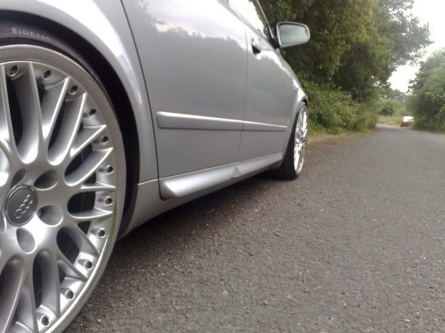

What like this...:arco:
Its all about the stance...
Poke=WIN:rock:
Poke=WIN:rock:
That looks ace !
Are they genuine Audi Rims or OEM's ? Take it your running 215's too ?
Is your car lowered any more then standard. Would love to see some more pics of it.

Yeah.. there legit S-line rims recently refurbed with polished lips..19'x9' allround 215/35/19 p-zeros..Avant is changing every week at the moment :keule:
That looks ace !

Hmmmm.... those look slightly strange.... IMO that pic is just confirmation that ET35 and 8.5J is the furthest away from OEM you should really go.
Don't get me wrong... those are absolutely magnificent wheels (probably one of my favourites), but could do with having a slightly higher offset and a little more width on the rubber.
I know they supposed to be S-line OEM, but which S-Line had 9" width wheels? The A6/A8 maybe? Pretty sure none of the A4-B6's...
The S4 had 8" and ET45, so the face of those are sat 28mm further out than OEM (16mm of offset and 12mm each side due to the 1" wider wheel)....
Also, the S4 had 235mm tyres, hence why those look so stretched (most manufacturers recommend that 215mm wide tyres go on a maximum of 8.5J wheels).... but to be fair, I don't think that 235mm wide tyres would fit on alloys that are that wide and with an offset that low.
Feeling very conflicted.... just about everything screams "yes" so much that it just end up being a scream.... hmmmm.....

LostBok, Thats the whole point of his Look, The Stretched Look, Think it was Intentional to make them look like that...maybe im wrong!
Nothing Strange about them IMO (of course)
Im sure Ive seen them alloys on the A3 Sline...
The offset doesnt matter as regards to whether the 235 tyre would fit the 9J alloy or not, Ive had 235's on a 9J no probs and they looked fine. Abit of a stretch but fitted without no probs at all.
The ET is on its own, down to how it will sit in the Arch and again, Looked fine....but again My "non O..E.:drag:..M" opinion!

J7 - I was agreeing 9J wheels SHOULD have 235mm tyres or similar.
My criticism of the tyre width was that he's running 215mm and most tyre manufacturers have a pretty wide range of tollerance, but they do have a minimum safe tyre width and on 9J's it is normally 225mm... and 225 will still look stretched: 215mm on 9J's is for show'n'shine cars that get taken to and from events on the back of a truck.
I know the offset doesn't change what size tyre will fit on each width of wheel... if does however create some issues ont he arches once you start pushign to extremes... if you have the car lowered and you're running significantly over spec wheels (7.5J OEM, so 9J is 38mm wider) and then trying to push the wheel further out too: ET54 vs ET29. So the centre of that wheel is 25mm further out and then add another 19mm each side (for the extra 1.5J), the outside edge of the alloy is 44mm further out than Audi ever intended it to be... I know the stock settings are pretty narrow, but 4.4cm is quit a lot... if you look at the photo's of that silver Avant, the tyre virtually taperers in to make room for the arch... if those were 235mm width (i.e. went up straight) I think he's get some rubbing because the actual height on a 40 profile 235mm wide tyre is higher than that on a 40 profile 205mm tyre.

..but thats the whole point of the Look, thats what I was getting at!
Im sure if he was looking at OEM then he would have chose the tyre accordingly...
If its the "stretched" look that he or many other are after then thats what is required, a "non Recommended" width tyre!
Also they are the A6 S Line Wheel!

:arco:I thought the tyres and low stance would offend some die hard pureists..but i have been running cars like this for over a decade and YES they are akward but i still manage to drive to the continent in them to attend shows and first and foremost this is how i roll...:lmfao:
If i wanted a normal car then i would just LEAVE it alone...
My last couple of cars were the same LOL...:scared2:

filthy - if you know what you're doing, then fine... I just through the tyre manufacturer's recomendations were for safety reasons...
All three of those all look pretty sweet... but personally I still draw the line around where J7's red devil was...
