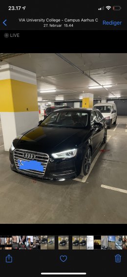

I’m considering to buy a pair of RS6 style wheels for my A3 2.0 TDI 2016 Sportback. It’s lowered with Eibach Sportline springs (35-40/45mm). Currently running on wheels that measure 19” 8.0 ET49 with 225/35-19 tires.
The wheels I’m looking at has following measures: 19” 8.5 ET42.
As you can see on my attacted picture, currently I have plenty of space and could use some spacers.
My question is; are anyone else running this setup I’m considering, will the wheels stick out (espessically in front) and if anyone is running same setup could you please share a picture :)

Thanks! Though I can’t really figure whether 19 8.5J ET42 will stick too far out in front. Most people running this setup in sedan, which I can understand is wider/got more space.
