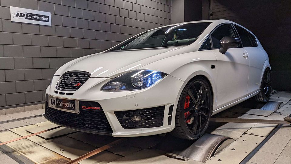

TTE480 Upgrade Performance Turbocharger VAG 2.0 TFSI (S3 8P, TTS, ED30, so on)
Seat Leon 1P Cupra R 2.0 TFSI 265pk by EVO RING
480HP & 563Nm
Specs:
Forged engine
TTE480 Turbo
Full Milltek catless exhaust
Upgrade intercooler
Schrick camshafts
Reinforced Springs Bartek
Ferrea valves (intake and exhaust)
Forged pistons
Forged rots
Sachs SRE Clutch
Integrated engineering intake manifold
Bartek LPFP
P4 Controller for tank pump
Loba HPFP
RS3 Injectors
Revo Air intake
JD Stage 4 software
RON98 fuel with 10% bio ethanol

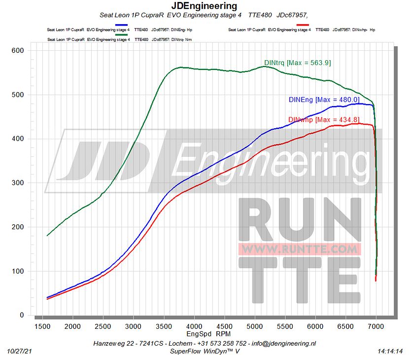

Seat Leon 1P Cupra R 2.0 TFSI 265pk by Evo Enginee Ring
OEM Specs: 265pk & 350Nm
JD Stage 4+: 480HP & 563Nm
JD Stage 4+: 492HP & 576Nm (with WMI)
