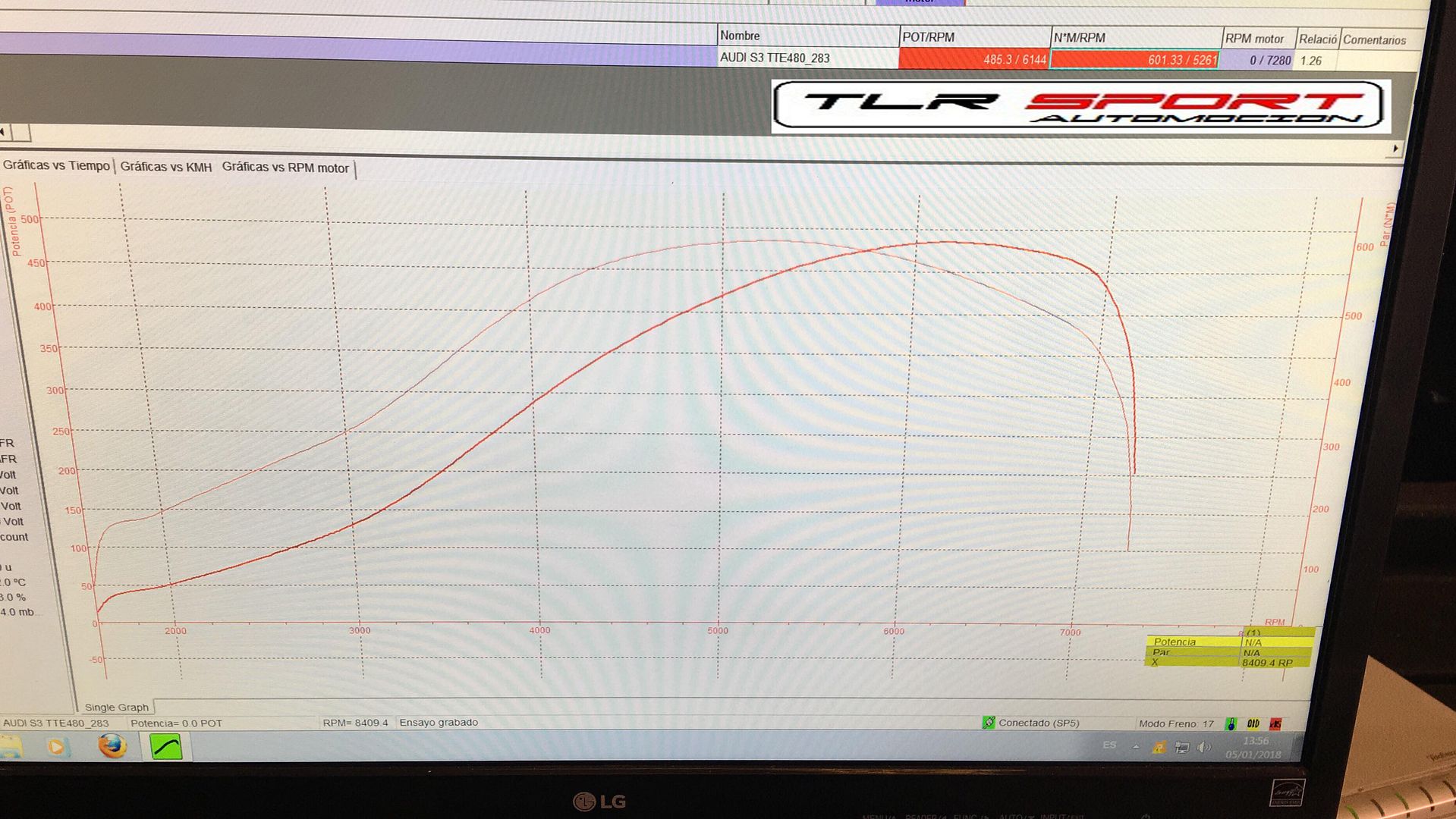

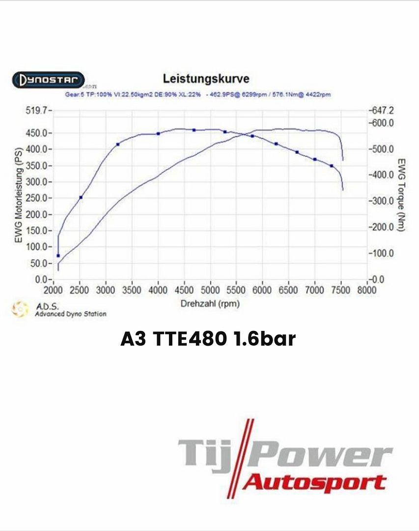

Sorry newb question. Are these dynos whp or adjusted for bhp?
Thanks!

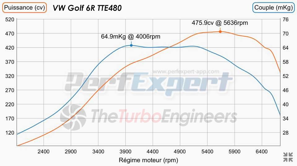

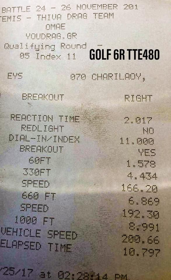

Heres a new TTE480 result...
GOLF 6R TTE480 AP-POWER
100RON BP fuel
1500kg with driver

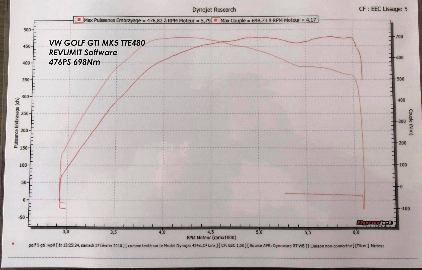

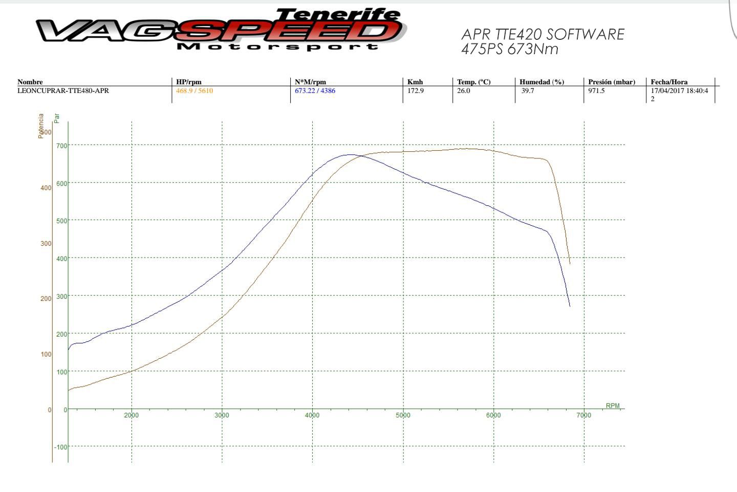

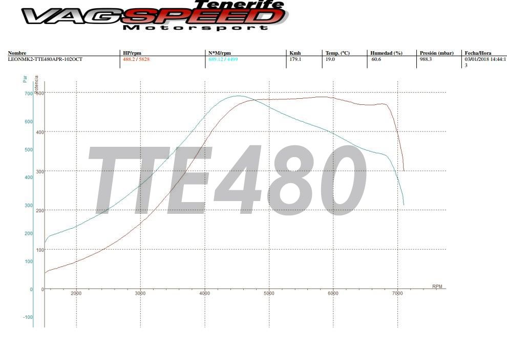

TTE480 package making 480+HP using APR Software.
SEAT Cupra 2.0tfsi
Full forged engine
APR Spring valve kit
APR FMIC
LPFP APR
HFP IE
165bar relief Valve
Turboback milltek
Tte480
Custom intake kit
Nkg BKR8EIX
OEM injectors (cdl engine)
Snow Performance water/meth
APR TTE420 software
This dyno is run with 102RON fuel and 102RON software
#TTEPOWER #TTE480 #GOAPR

Might be a stupid question but why hp is dropping so much in high rpm - stock catback or what?
Might be poor tuning, i reviewed some dynos from the other pages quickly and most do not drop off that significant. But it seems after 5700-6000 power does start to fall off.

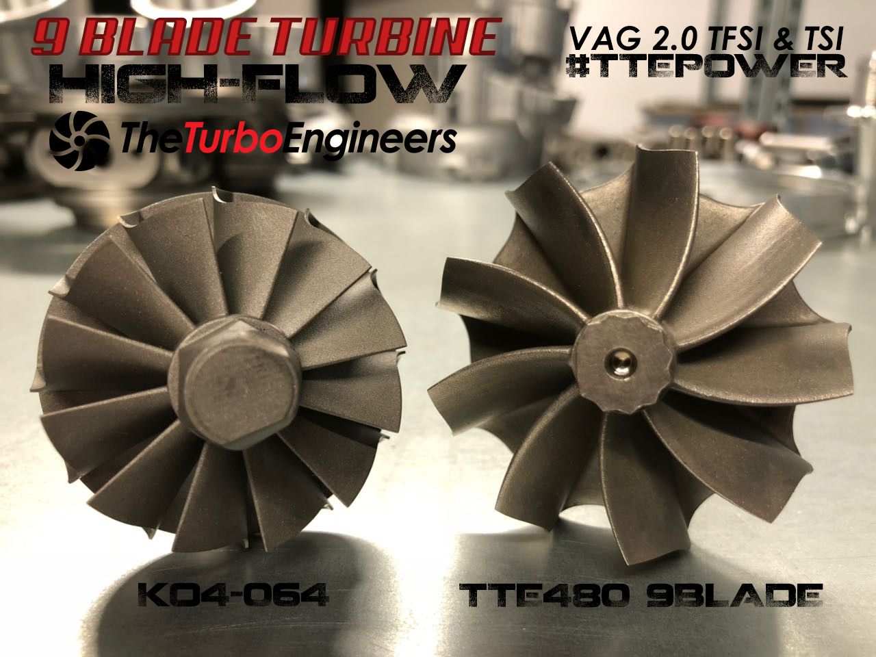

I'm interested in the benefits from this new 9-blade turbine.
Also, does the turbo come with N75 or do you have to swap over from old turbo?
