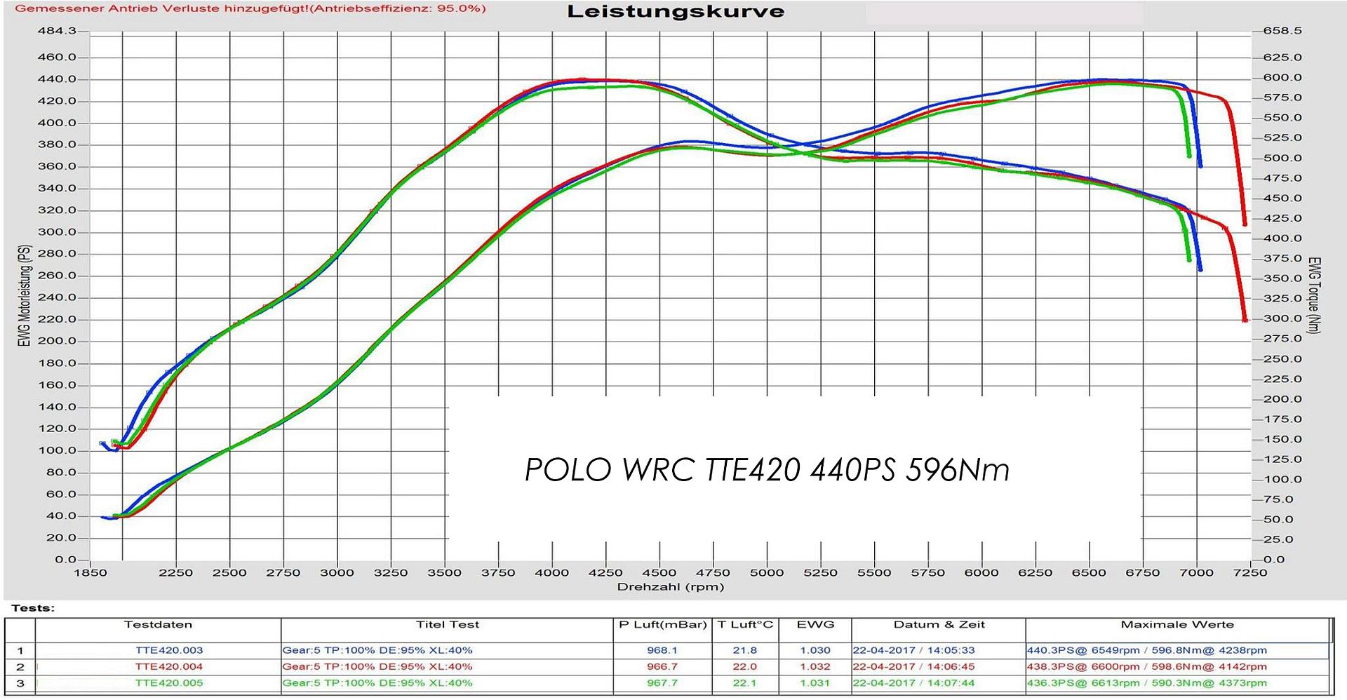

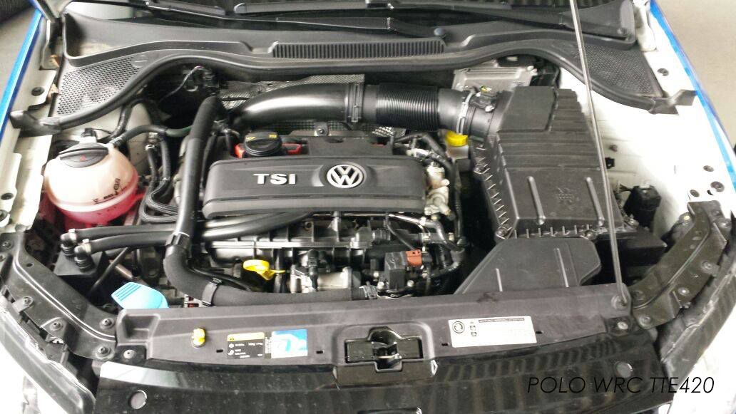

VW POLO WRC 2.0TFSI 220PS / 350NM
Setup:
- TheTurboEngineers TTE420 Turbocharger
- Wagner Tuning Intercooler
- APR UHPFP
- TTRS Intank pump
- Bull-X 3" Downpipe with CAT
- Miltek Exhaust
- TTRS intake
- RS4 fpv
- RS4 Injectors
- Sachs Performance clutch
- Neuspeed Turbooutlet
Sl-TUNINGSOLUTIONS SOFTWARE
100 SHELL VP 440PS 596Nm (EWG):racer:
#TTEPOWER

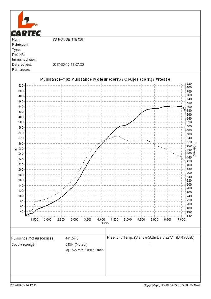

AUDI S3 TTE420 By KFS Motorsport with MRC Tuning software
- turbo tte420
- reprogramming mrc tuning custom
- Wmi Kit
- upgrade intercooler
- intake ITG
- upgrade hpfp and intank
- HPA motorsport inlet mani
- Rs4 b7 fpv
- r8 injectors
- full 76 mm exhaust
441PS 549Nm

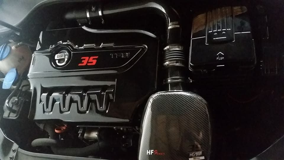

Christian Schneiders Black Spark Edition 35 Projekt TTE420
TTE420 Turbocharger & TTE SILENCER Delete
3"EgoX with Downpipe BULL X Exhausts,
HG-Motorsport HF-SERIES Air intake
HG-Motorsport HF-SERIES Intercooler
Audi Deutschland TTRS injection
NGK Spark Plug
Upgrade high-pressure pump
Carbon Petri Performance Parts
Hardware Installation of Reifen-Winkel
H&R monotube coil overs
R8 Break and RS3 8V Wheels
Michelin 225/35R19
Software from Fts Fahrzeugtechnik
Result 429PS 527Nm
#TTEPOWER #TTE420 #FTS #ED35

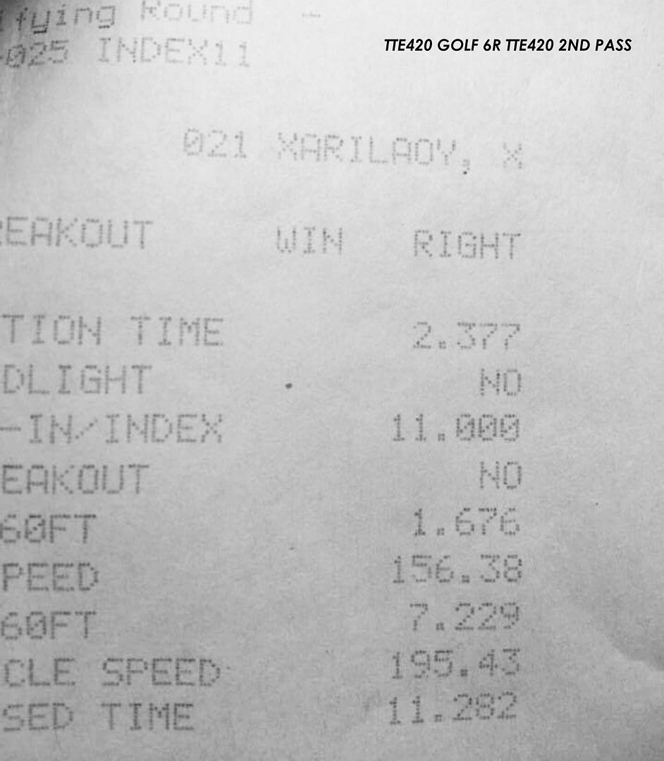

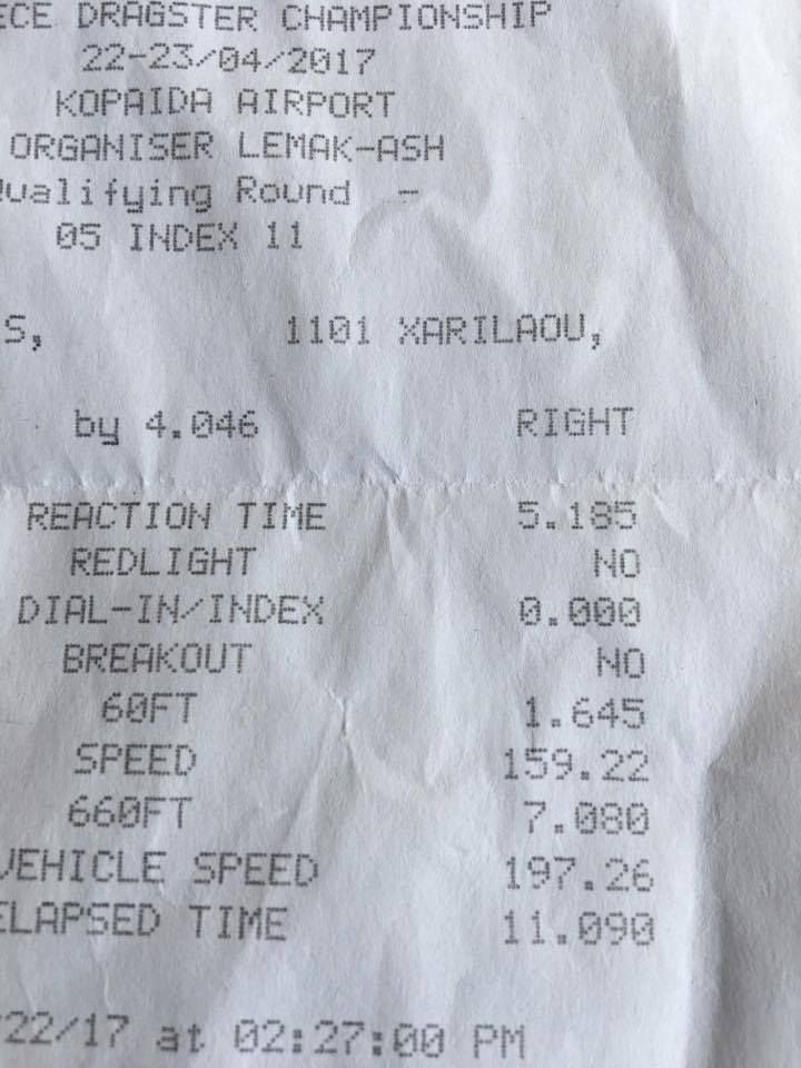

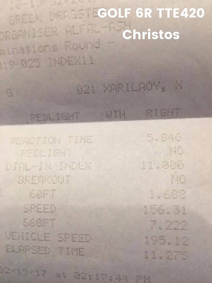

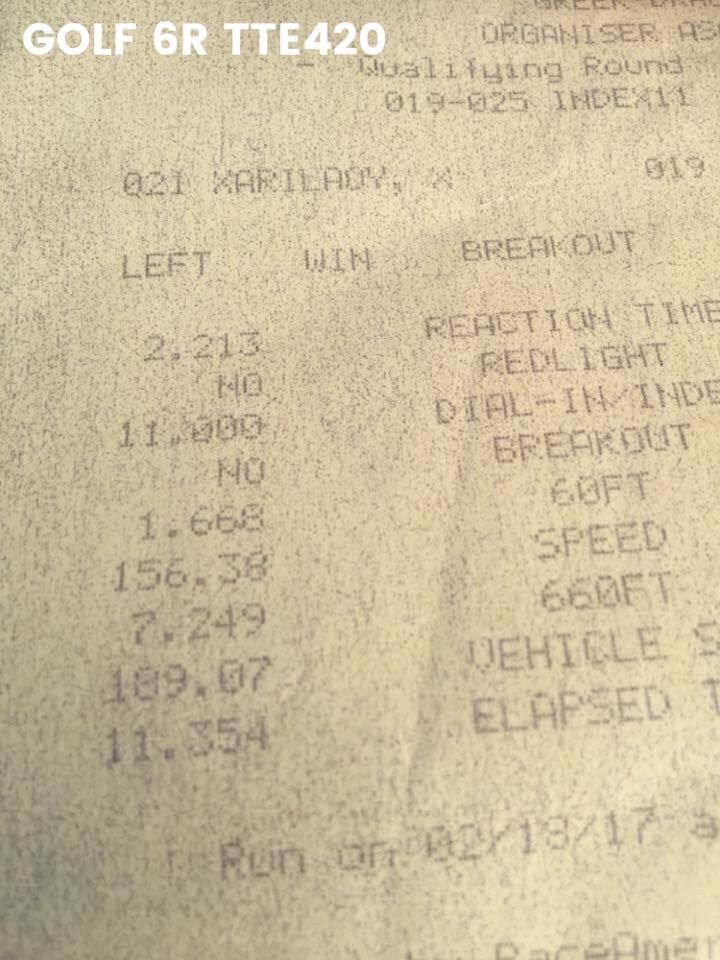

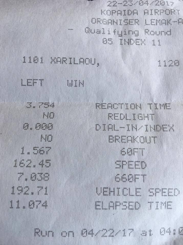

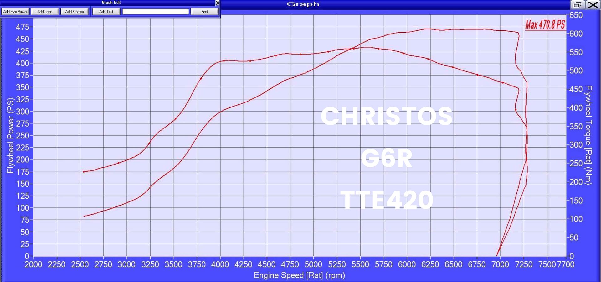

Congratulations to Christos Charilaou taking First place
for a third consecutive time at the drag battle 2017 in Greece this weekend,
VW GOLF 6R TTE420 (470PS)
Running the best time on the day of 11.1sec @195km 0-402m (1/4mile) with ambient temps of 38 Degrees of temperature
That 10 was there if temps were cooler maybe...
#TTE420 #TTEPOWER #DRAGBATTLE #G6R

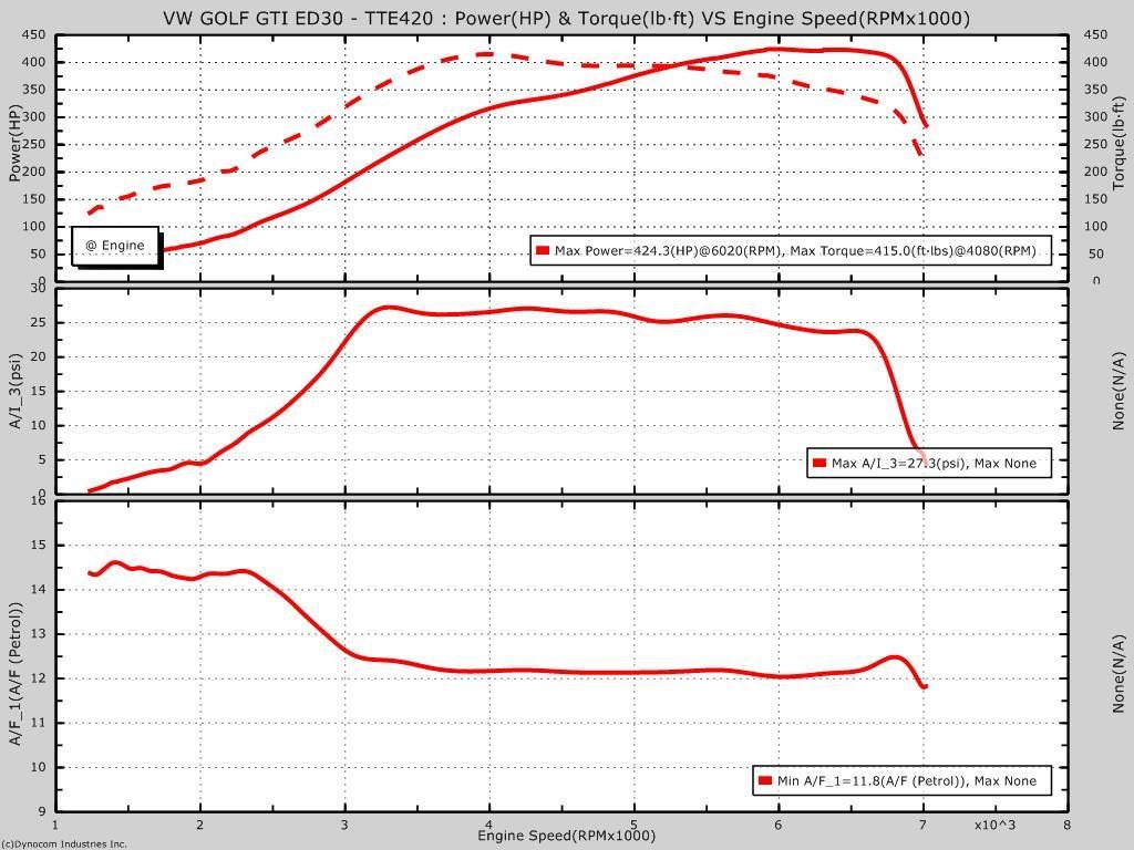

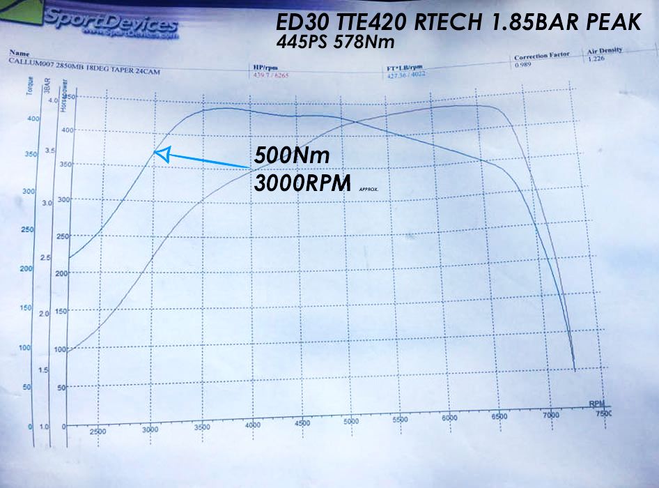

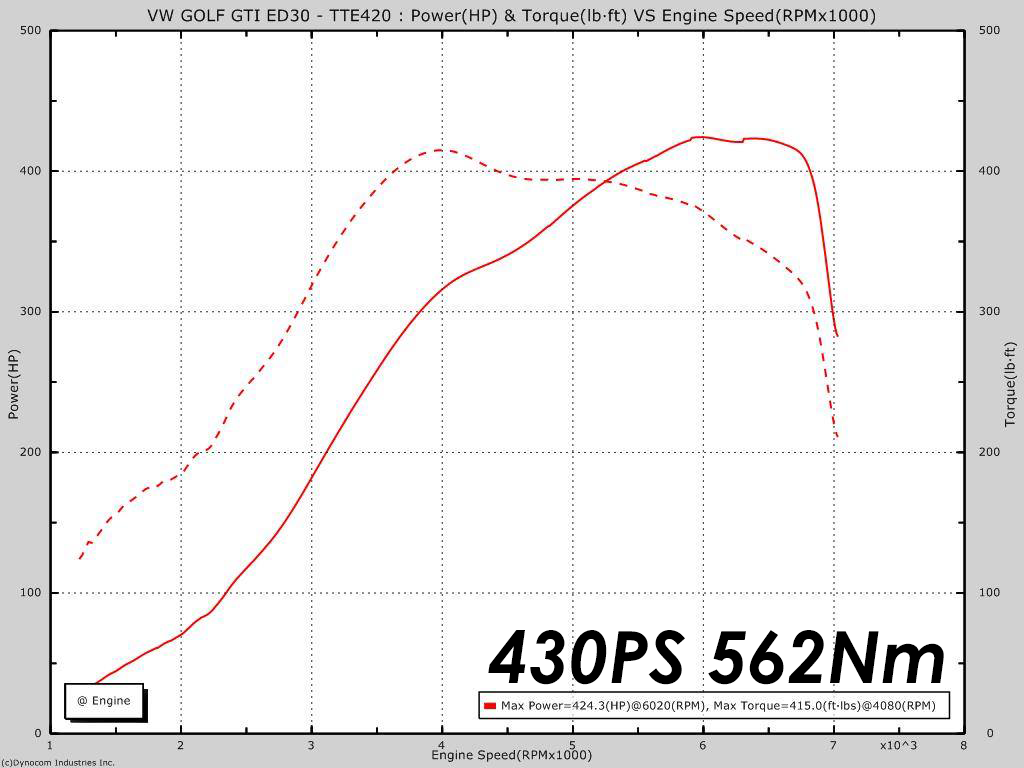

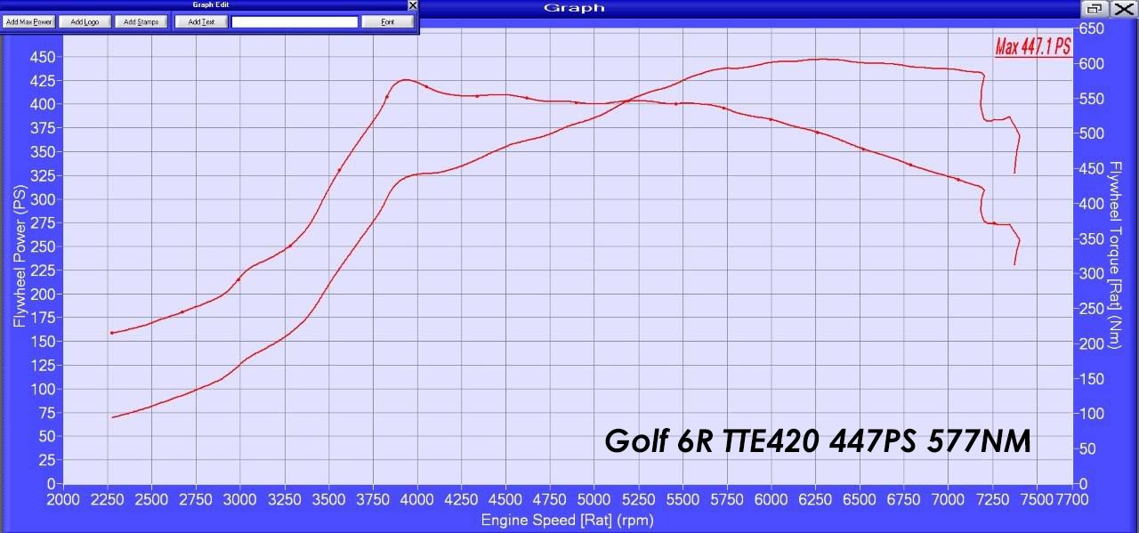

Callum Stockdale's VW ED30 GTI TTE420
Check out his dyno test report from his last tuning session at R-Tech Performance Tuning in the UK
His set up produced 445ps and 578Nm @1.85 bar peak and tapering
Forgetting peak figures alone his full set-up shows great response with it making approx 500nm at 3k RPM also notice the way it holds a big area of torque.
#RTECH #TTE420 #ED30 #HYBRID

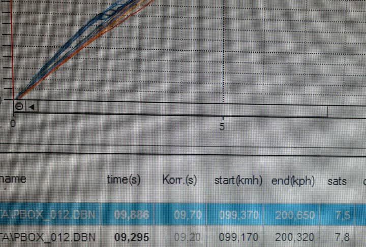

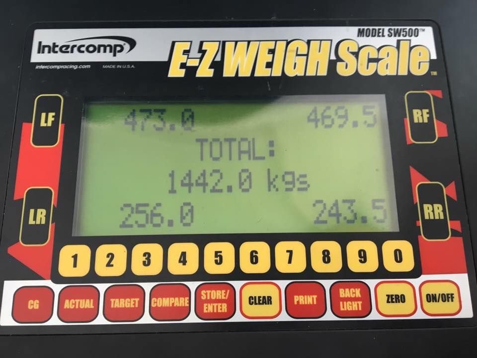

New TTE Owner Time entry......️
Otto Müller's S3 TTE420
Audi S3 8P Manual trans
TTE420 Upgrade turbo
TTRS Intank Pump
Porsche injectors
HPFP. Upgrade
3 Inch DP
ISR H rods
Mahle Piston
Hfi V2 Suction
Wagner Intercooler
1560 kg + 75 kg driver and full tank = approx. 1690 kg total

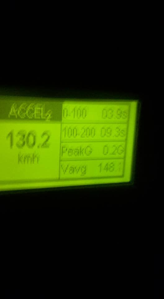

Joe's Kfz - Werkstätte ECU Software 1,8 bar overboost 1,6 bar holding
9,2 Seconds corrected 100-200 Kmh ✊
https://www.theturboengineers.com/100-200-1-4-times
Audi S3 8P TTE Schalter
1560 Kg + 75Kg Fahrer und voller Tank = ca. 1690Kg Gesamt
TTRS Intank P.
Porsche Düsen
HD P. Upgrade
TTE420 Lader
3Zoll Aga ab Lader
ISR H Schaft Pleuel
Mahle Kolben (Übermaß)
HFI V2 Ansaugung
Wagner LLK
1,8Bar fallend auf 1,6Bar Ld bei der Messung
9,3 Unkorrigiert 9,2 Korrigiert 100-200 Kmh
