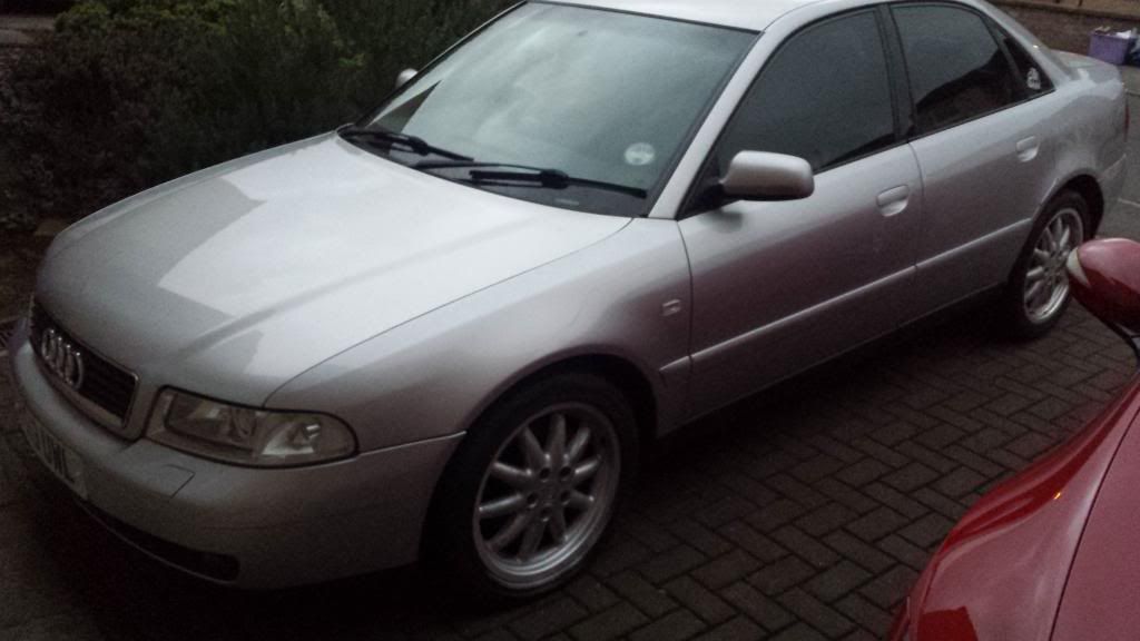

Here's how it looks now:

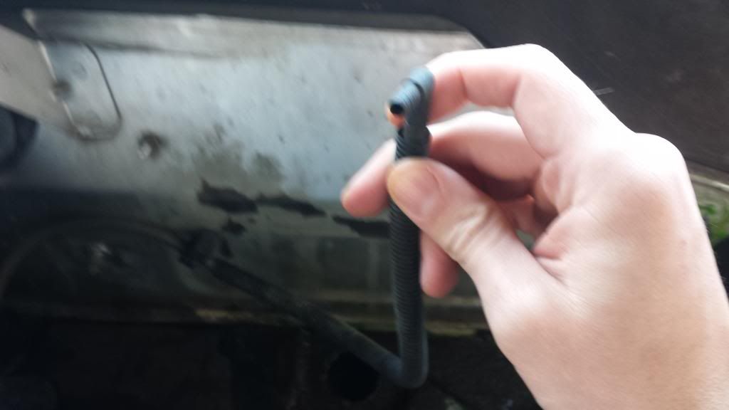

Guys.Whats this small pipe for? It comes up just next to brake servo near battery. Not connected ro anything in the car. Is it the one that goes to the battery itself?

Yeah that's the battery vent tube,

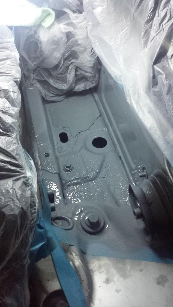

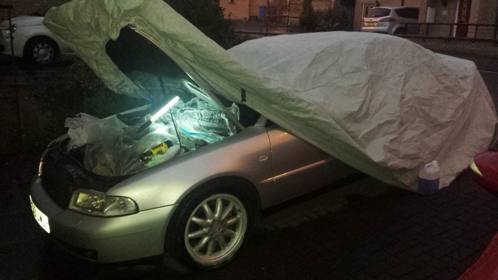

Day off today so had some time to work on the rust.
Took me 4 hours with various metal brushes, sand paper and hammerite rust remover to get it to how I wanted.
Had to run to halfords to get some primer. When got home it started raining so I had to come up with something creative.
Two coats of primer later
Hopefully it won't rain tomorrow after work so that I spray it and move on to another thing.
