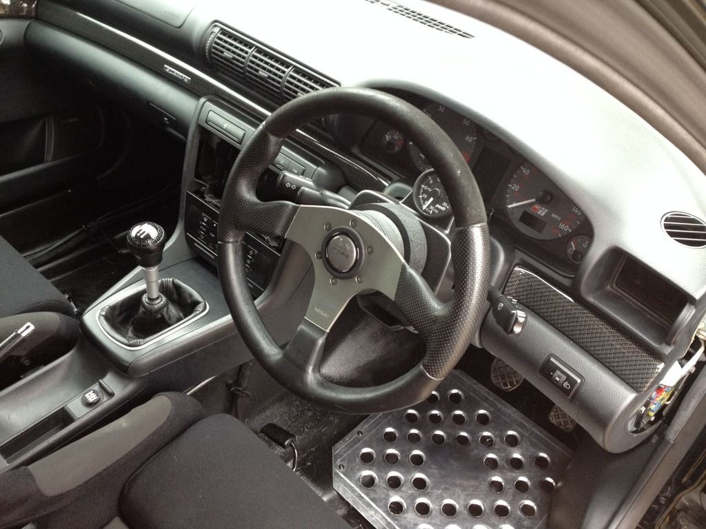

    set about removing some weight so out came the stupidly heavy recaros, carpets, stereo and airbags, the exposed wiring bugged me so wrapped it all in harness tape

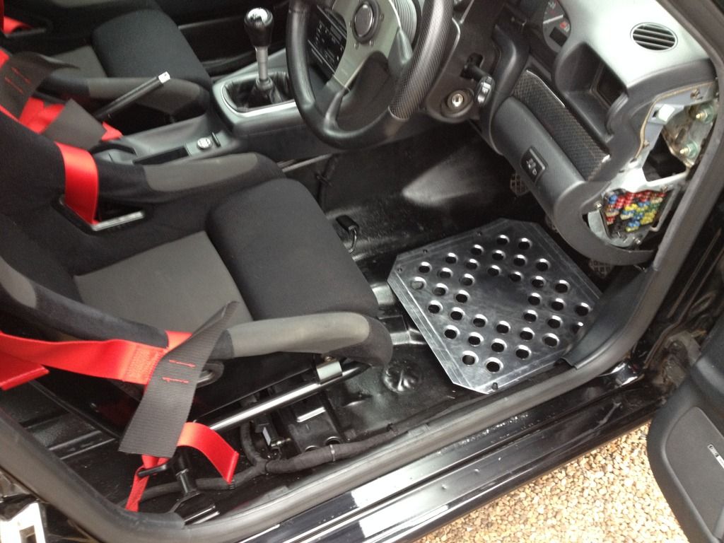

    fitting still meant welding in the box mounts so before that I removed every piece of sound deadening, which was surprisingly heavy, once it was in I painted everything satin black to tidy it up
    [​IMG]
    other issues were the not so flat floor and struggling to reach the gear knob so back to ebay for a floor plate and made an extension from an old socket and a bolt
    [​IMG]
    [​IMG]

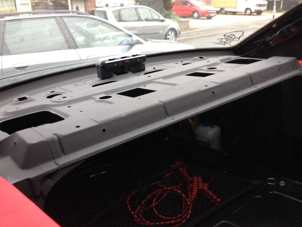

    another issue I had was reflection of the shiny black rear shelf on to the rear window so got some blackboard paint

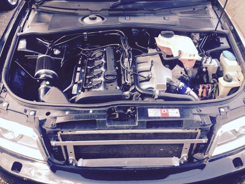

    mechanicals
    k04-15 turbo
    ebay intercooler
    icm delete
    cone filter
    silicon hoses
    ebay quick shift

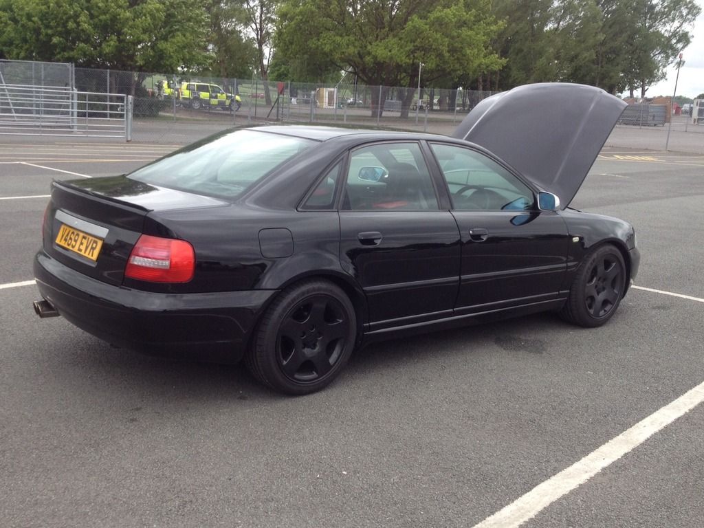

    time for a bit of an update
    ive added new wheels, some team dynamics 8 x 17 in gloss black
    also some b8 s4 front calipers with b6 s4 discs and facelift b5 s4 rear brakes all calipers have been painted red
    [​IMG]
