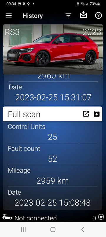

I do my first scan on the 25 control units and 52 faults are counted ( perhaps many due to negative battery disconnections and reattachments made in the past ) .

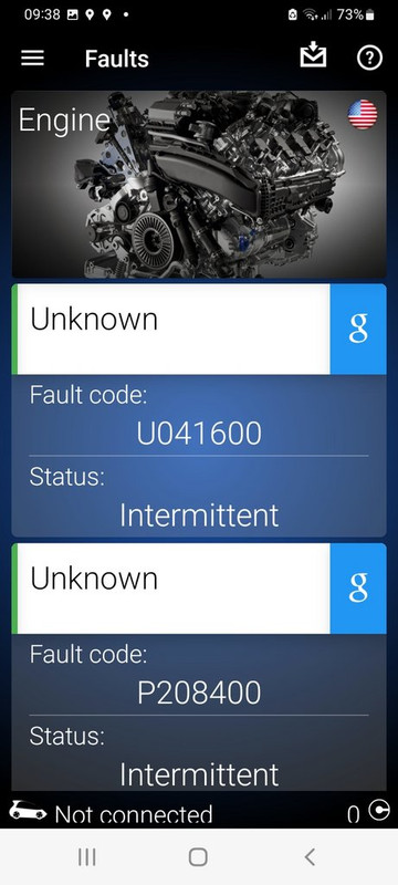

In group 01 of the engine electronics, 7 unknown faults were found.

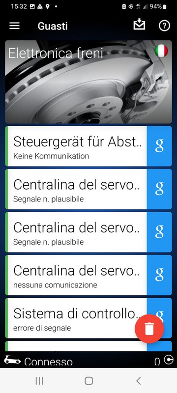

The faults in the other groupings were recognised.
I tried to delete some faults individually but the application could not do so.
I tried mass deletion but after a first attempt 22 faults remained on 4 ECUs, after a second attempt 7 faults remained on 3 ECUs.

I could read the 7 active faults in 01 engine.
They are U041600 - P208400 - P208600 - P208000 - an error with no code - U023500 - P1A9100

Passive is intermittent faults, don’t worry too much as the 8Y can be full of odd error codes I’ve found, active are ones that are actually ‘live’ so to speak.
