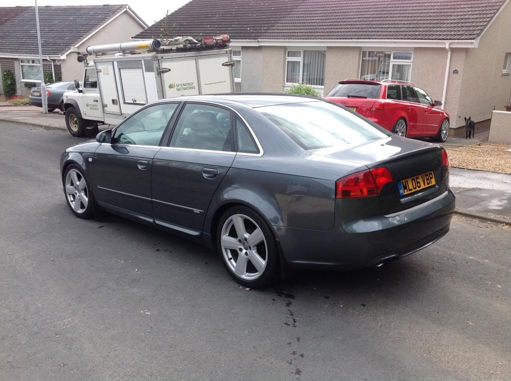

I've just put the Bilstein B4 (make sure you get the sport shocks if you go for these) and Eibach Pro combo on my saloon and it drives well. Its a lot sharper when turning and less body roll (I had SE suspension before). It is a little bouncy on the motorway though but not uncomfortable.
Also I've noticed that the rear of the car seems to sit lower than the front... Not sure if this is normal, and is it likely to be level once I swap to a new set of springs?
This is normal, the back of my saloon sits lower than the front even with the new shocks and springs.
