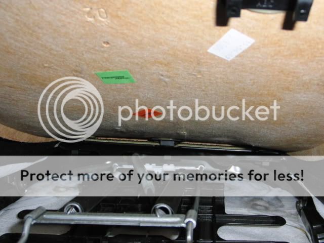

Hi Guys,
Got a broken back on my drivers seat. Looks like the bottom clips are broken, but im not too sure how i can take it off to fix. These are the pictures i've managed to take. Can any let me know how i can remove this and fix it?
This is looking up a the connections
Graham
The top has sprung clips so should pull out - although may be safer to use a trim-priser.
I think you can see the 3 clips at the top of the 2nd picture.

on closer inspection you will probably find that the lumbar support has broken causing the seat back to be pushed out breaking the securing clips. i have got the same problem with mine but just haven't had time to order the parts with PJMSpeedy to fix it. you can tell if the lumbar support has broken by placing your hand on the lowest cushion/lumbar part of the seat and if it is very lose/slack and not taut it is broken, luckily its a very easy fix...

After looking again this morning it looks like my lumbar support has broken. I've checked on ETKA and the part is just over £50 including VAT. So this will need doing before the clips are replaced.

I've just had this happen to me.
On taking the back of the seat off the lumbar support is broken as well.
Have ordered the seat repair clips and new lumbar support from TPS, they should be here in the morning for me to fit them using THIS excellent link posted above.
HERE is the guide for the repair kit.
