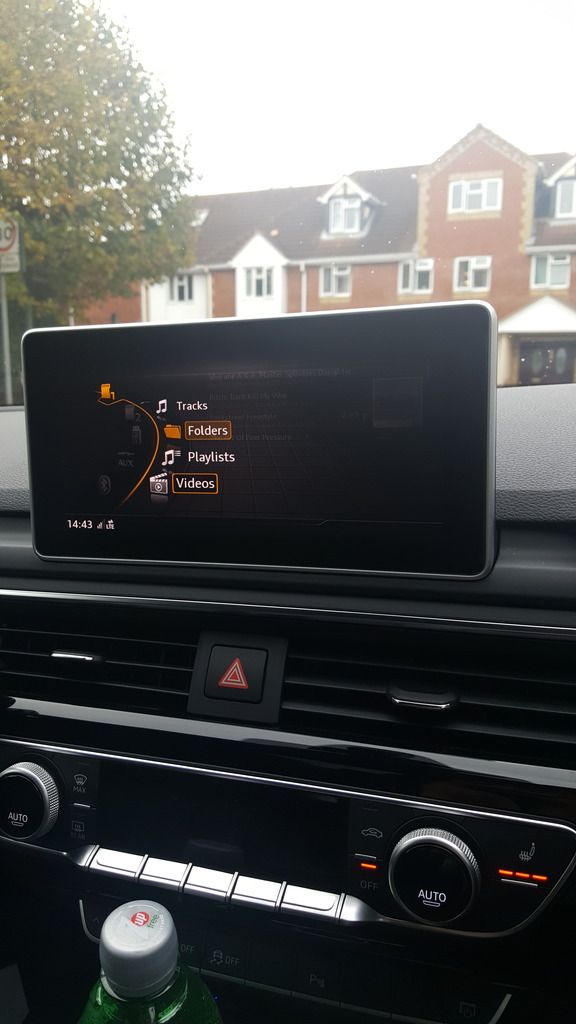

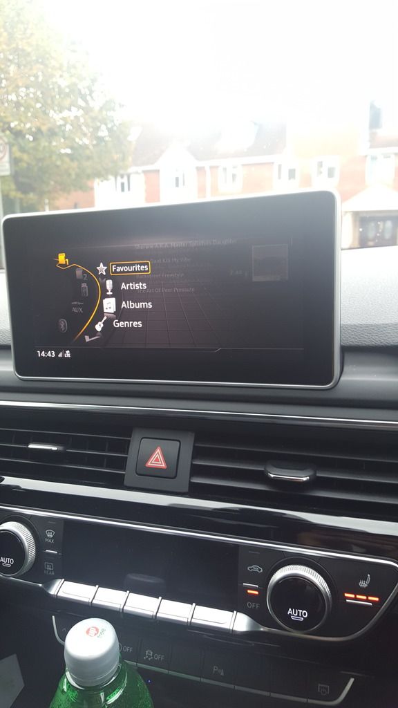

I will send you a picture of how I did mine tomorrow mate. I've got two sd cards one 16gb and one 64gb SanDisk sdhc

Here are the pictures showing mine as folders. On the mmi controller the left button next to the controller when you are scrolling through should allow you change how you want the tracks to lay out as shown in picture 1 and 2
